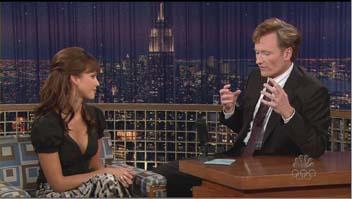

DV, DVD and digital broadcasting all use the same pixel aspect ratio (PAR) for 704x480 or 720x480. The 704x480 center defines the true 4:3 image. 720x480 adds 8 additional pixels on each side that were intended as a guard area for unstable H position. 704x480 is used for 4:3 digital broadcasting.
If you are using your camcorder to record TV or other NTSC, you will see 8 pixel black stripes down the sides like this when you capture the full 720x480. This is normal.
For DVD you can trim 8 pixels from each side and author 704x480. No resizing is needed.

If you capture a 704x480 broadcast into a 720x480 raster, you get ~8 black pixels left and right as shown above whether the aspect ratio is 4:3 or 16:9. Image pixels lie in the central 704x480. You can crop off the side pixels and author a 704x480 DVD for perfect 4:3 or 16:9 playback on any DVD player. Or you can author and play the 720x480 capture file as 720x480 but the black side pixels will show. The black sides are usually not seen on a TV due to overscan but they may be seen with computer players.
