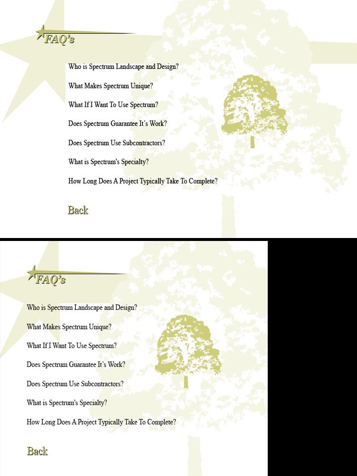

	like i said, a lot of the content is going to be text, so to me making two separate menu systems would be ideal to utilize all the viewable space possible as well as displaying the correct resolution of the content on the screen, here is a wip of one of the faq menu

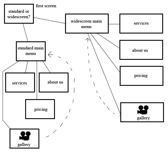

	ok ive figured out how to set different aspect ratios to different VTS menus, i guess what i need help with is setting up an initial menu where the viewer selects widescreen or standard, and then setting up the two different VTS menus so that returning to the main menu will take them to either the main widescreen menu or the main standard menu, depending on the initial selection
