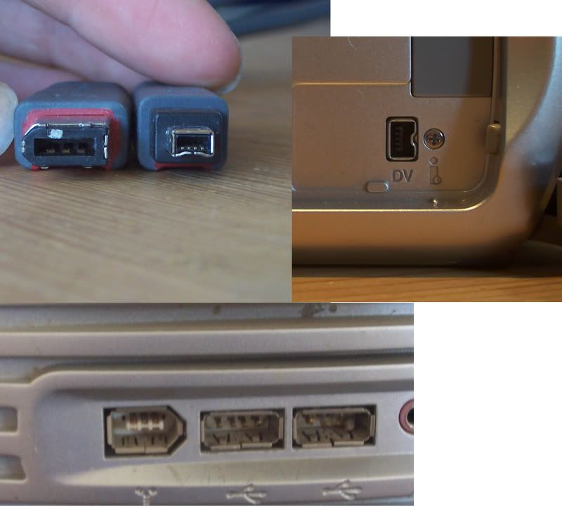

    May 2007
    Here are the bits and pieces I am using - the computer port, the dv bit on the camcorder, and the cable.
    incidentally the USB ports next to the firewire port on the computer, they work fine.
  13. Going Mad TheFamilyMan's Avatar
    Jan 2004
    south SF bay area, CA USA
    Originally Posted by emilymeg
    hmm I appear to not have that device. What might that mean?
    From what you've stated it seems that internally your computer does not have a firewire, even though the case has a connector for it (IMO that is a bit strange). If possible, check your computer's owner's manual to see if it really has a firewire device. It should also have instructions for connecting these devices as well, but it sounds like this is not a problem for you. If your computer really does not have a firewire, you can install a firewire PCI card that can be internally connected to case's connector. A local computer shop would be able to do that for you, or you could do it yourself. It's really quite easy to do; a local computer shop might do it for free if you bought the card from them.

  14. Member JonnyCabs's Avatar
    Oct 2006
    Where did you buy the computer from
    I bought last year from Mesh, who use a generic case which has
    both USB and Firewire ports on the front and the back.
    The USB cards are pre-installed automatically but not the Firewire
    Whilst the ports are there i would have needed to ask them to supply with a Firewire card installed for any of these type of ports to work.
    This is most likely the answer to your problem, and therefore TheFamilyMan's suggestion is spot-on. Go to your local shop and ask them to install a Firewire card.
