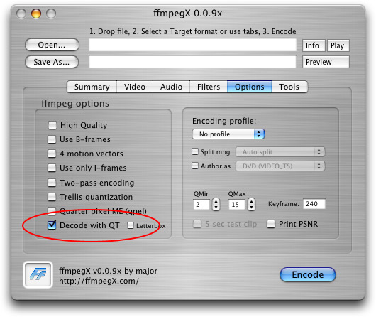

If the file plays correctly in QuickTime Player, then you could try to activate Decode with QT in the Options tab. ffmpegX then uses QuickTime (which uses Flip4Mac) to decode/read the file, hopefully including audio, so that ffmpegX can encode it correctly.
