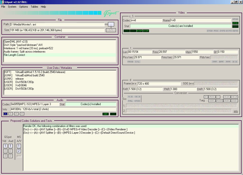

    I just took a VOB and edited out four or five scenes, compressed the video to XviD and converted the 48000Hz audio to 44100Hz 16bit Stereo and compressed to 44100Hz 128kbps Stereo MP3 with no sync issues at all. Since this was an MPEG-2 file and I was Full Processing the video and audio, I was able to do frame exact editing.
    Here is my GSpot screencap

    I made an xViD encode from a video i cut parts out of, but direct streamed the AC3 audio and the stream lengths were the same, and in-sync.
    Edit: Problem solved if i encode the audio outside of VDM using Soopa's AVI Gain v05.
    It encoded to mp3 and remuxed perfectly, see his thread here:
    https://forum.videohelp.com/topic314909.html
