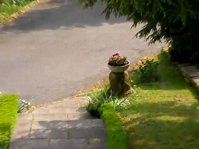

You're experiencing macroblocking on certain shots, which is a common problem and can be eliminated through a number of different techniques.
Found some clips from your specific model of Sanyo camera so we can all have a go at addressing your issue.
http://www.mediafire.com/?4mjmr2vz2dj
http://www.mediamax.com/joganakin/Hosted/SANY0004-TVHQ.MP4 <---Good to show pre-macroblocking
http://s26.quicksharing.com/v/1202955/SANY0364.MP4
http://s26.quicksharing.com/v/1717870/SANY0240.MP4.html

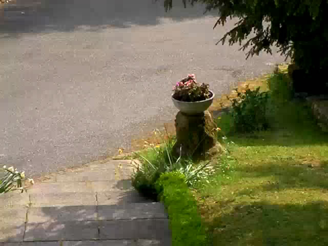

H264 is quite good at avoiding macroblocks - turning the scene into "slurry" at times, especially on large, flat areas, such as the pavement in this shot.
If I turn off the built in deblocker in the h264 codec, the scene becomes quite a bit worse.

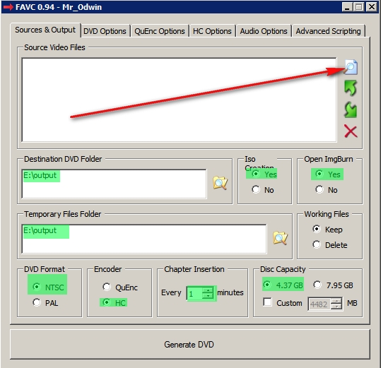

Here's a free method, although the prepared scripts could just as easily be used to feed ConvertXtoDVD. It uses Avisyntth and a free app called FAVC to create a very high quality DVD. BTW - Once you have this set up, it'll be 2-3 clicks to create a DVD.
Prequisites:
1) Avisynth 2.57 or greater
2)FFdshow or CoreAVC - if ffdshow, make sure during installation you set it to play h264
3)Haali Media Splitter - make sure you choose support for MP4 during installation.
4) My file pre-processor script, download from http://www.sendspace.com/file/xho7zg
Procedure

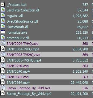

1) Unzip the preprocessor file posted above. You'll find 2 folders. We'll start with PRE_PROCESS. That will be the folder where you'll place your .MP4 files for conversion to DVD.
2) Copy your MP4 files into the PRE_PROCESS folder and double click _Prepare.bat to run
3) Once completed, you'll find the .AVS files, which you can feed to ConvertXtoDVD, or to FAVC

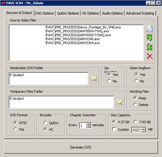

4) Go into the FAVC folder and click on FAVC.EXE to bring up GUI. Figure out a place for the app to create the files for burning. In my case, I created a folder called e:\output. Make sure the rest of the settings are ticked as below. The red arrow points to the open source files button. You'll want to enter your AVS files...
5) Like this...

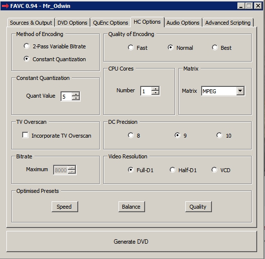

6) Now a few settings to click in the tabs...
7) Make sure the HC settings are ticked just like this

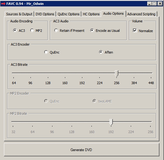

8.) Same goes for the audio
9) And especially the Advanced Scripting Session. Now you can click the GENERATE DVD
10) It'll seem like nothing is happening, but indeed it is. In a minute or so, you'll see the media being encoded into MPEG2.

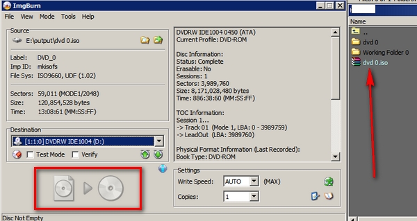

11) Place a blank DVD into your burner and click the area in red to burn...
I wish the prerequisites were fewer, but encoding H264 to MPEG2 is a PITA.
