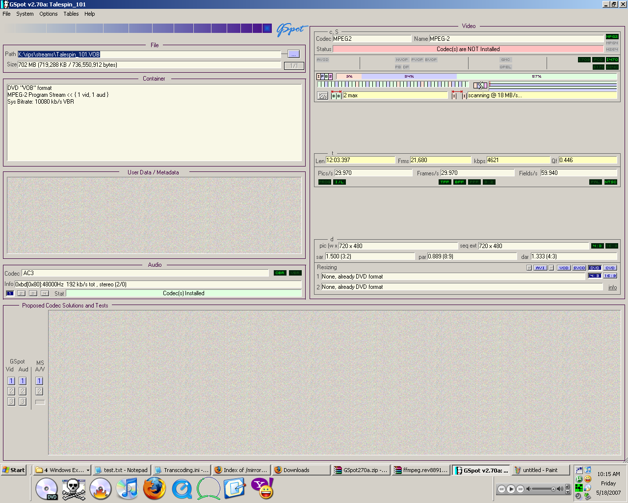

    Well your ffmpeg can't see an audio stream in the input...
    Can you open the file in gspot and post a screenshot?
    That said you have a 18 month old version of ffmpeg and so using the latest version may well solve your issue.

  9. ANy help?
  10. Member ChrissyBoy's Avatar
    Feb 2003
    Yorkshire!
    Well yes. There is audio (as you know as you have heard it!) - more importantly, the audio stream is bonefide. In general ffmpeg would have no issue with it but your 18 month old build does. ffmpeg development is very fluid and everyday a new build can be compiled. Either compile the latest from svn or locate the latest binary you can find. Maybe from : http://ffdshow.faireal.net/mirror/ffmpeg/
