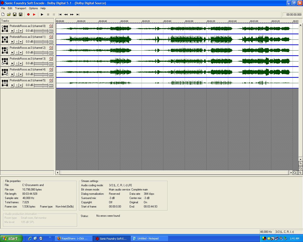

    Below is a graphic of the MP3 in GOLDWAVE followed by a graphic of the 5.1 AC-3 in Soft Encode [please note the images are 1280x1024 which is my desktop resolution]
  23. Member Soopafresh's Avatar
    Jan 2004
    Hey, thanks a lot, John. I appreciate the time you spent. Yeah, the volume thing has been a source of contention - make it the same db and folks complain that it isn't loud enough, or make it louder and risk bouts of nasty digital distortion. Good point on processing music mp3s - no need to kill the dynamic range by cranking up the track volume. I'll make some modifications for the next revision. thx
