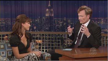

The HC-3 can convert 1440x1080 HDV to 720x480 DV over IEEE-1394 on the fly. HDV is by definition 16:9 so the DV out will be wide mode DV.
Most DVD recorders that have an IEEE-1394 input will record that as 4:3 so it will look horizonally compressed like this and for most recorders will not include DVD wide flags.
A DVD player or 16:9 TV will have screen aspect ratio controls to stretch that out to 16:9 like this.
The DVD will need to be reauthored to add the wide flag (e.g. IFOEDIT ) so that DVD players can handle it as a normal wide DVD including letterbox modes for 4:3 display. -
