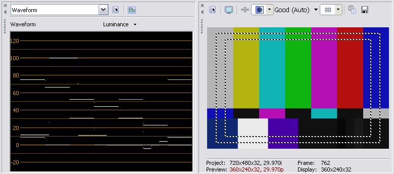

    Here is a SMPTE DV color bar that was transferred over IEEE-1394 and recorded to Digital8 (DV) tape and then transferred back from tape playback to the DV timeline. It is near identical to the signal sent. This has been true for every Digital8 or MiniDV camcorder that I've used.
    Signal sent to the camcorder
    Playback transfer over IEEE-1394 to a file.

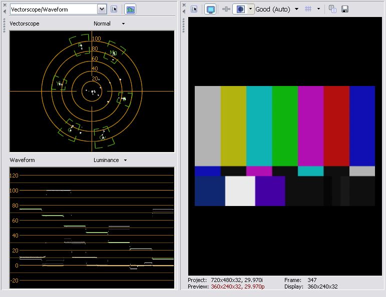

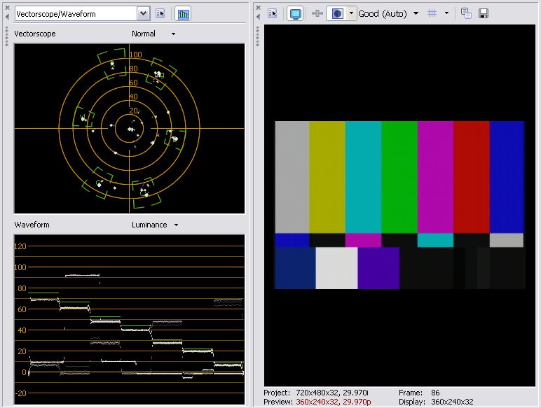

    Here is the same file playback through the analog camcorder outputs captured by the Canopus ADVC-100 to DV. The Canopus path was calibrated and known good so this represents the DCR-TRV-103 analog output.
    As you can see the lumiance path has problems although chroma levels are satisfactory.
    Prosumer camcorders perform better than this for analog and are usually within a couple of percent.

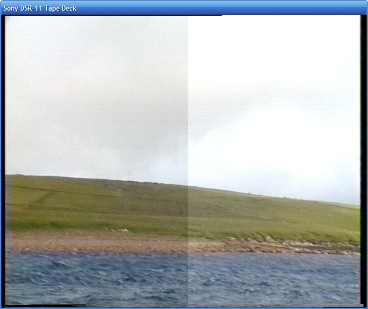

  7. By way of example, here is a frame from a Video 8 source captured as DV via pass-through (a Sony DSR-11 deck). The left half has the luma decreased by 7.8% (the nearest you can get to 7.5% with the 220-step quantization of DV), the right half is as-is. (The source is PAL but it shows the effect.)
