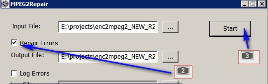

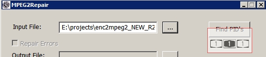

    Are they MPEG Transport Stream Files ? Run them through Mpeg2repair before demuxing them.

  8. Member Soopafresh's Avatar
    Jan 2004
    Mpeg2Repair strips out the non-HD subchannels or PIDs . Many Mpeg editing/cutting apps get confused when there is more than one video track in a file. Try scrolling through a TSP in ProjectX - you'll see it jump all over the place. You can remove the unneeded PIDs within ProjectX itself, but the process is...for lack of a better word...yucky.
