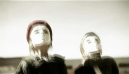

http://www.yayofilms.com/clients/1976/monmasque.mov
So horrible...I knowEric T. Edwards
eric@ecpfilms.com -
Excellent Rodriguezish cinematography there. A great look.
On first play it appears to have motion issues. It could be the mov.
All this was done from an FX-1 source?
Are we looking at composites or is this processed from the camera direct?

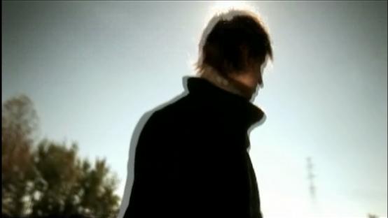

MOV export may be the issue but the kind of things I'm talking about appear in the folloing frames.
This ghosting represents a possible artifact of 29.97 to 23.976 fps conversion but it may be due to mov conversion.
I'm stepping through this in 24p but still see frame ghosting. -
There is ghosting in the movie trailers on apple.com for the departed and 300 too on quicktime...big deal.
Look at the guys hand and the guys face...
