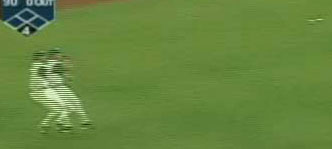

    Note in the picture above, each field has some motion blur (e.g. the oval shaped ball) but each field is sharp. It is the deinterlacer that causes field to field "blur".

    Good hardware deinterlacers will do motion analysis at pixel level on each of a series of frames and switch deinterlace strategies on a pixel or pixel block basis based on the amount of motion and surrounding video characteristics. Slowly moving areas will trigger bob and weave strategies to build up resolution. Faster moving areas will favor field to field motion detail to avoid blur. The eye is sensitive to motion accuracy but not to detail in areas that are moving.
    The more sophisticated hardware deinterlacers are found in premium progressive DVD players and upper tier HDTV sets. A quality hardware deinterlacer will improve the look of 480i, 576i and 1080i video. In contrast, cheap progressive DVD players and progressive HDTV sets will perform poorly with 480i and 576i sources. 1080i won't have as many problems since the pixels are relatively smaller.

    True motion blur is very subtle like that baseball turning into a oval or spinning wheels blurring when viewed from the side. Most mention of progressive monitor blur in areas of the picture where moving objects blur out or break into pixels relates to inferior deinterlacing methods collectively known as blend deinterlace. Blend deinterlace is the cheapest and ugliest way to deinterlace video.

  14. You 60 fps progressive sample was almost certainly captured as interlaced and then blend deinterlaced. Notice how the fast motions look like double exposures.
