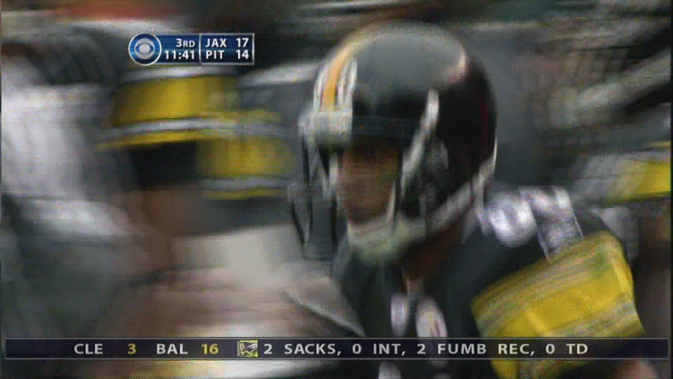

Right. Although some types of deinterlacing or improper treatment of interlaced material can lead to something that looks like motion blur.Originally Posted by Dark Alpha
ya, I know de-interlacing, pixel response time, scaling and video enhancement (such as noise reduction, edge sharper, etc...) can cause motion blur so that’s why I concentrated solely on CRTs
PS: What's with the very high noise reduction on the image above? -

That was just a frame out of a 1080i MPeg2_TS stream. Blame CBS or Comcast for overprocessing. It may have been an instant replay.Originally Posted by Dark Alpha

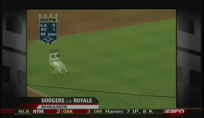

If you spin the table at 480i/29.97 and connect directly to an interlace diaplay, there will be 59.94 unique time sliced fields per second. If you do the same with 480p/59.94, there will also be 59.94 time slices per second on an interlace display.
If the display was a PC progressive monitor with no deinterlace, you would see 59.94 fps time slices per second for 480p/59.94 but for 480i/29.97 you would see frames containing fields offset in time by 1/59.94th sec. like this. Since the PC requires fields to be paired into frames, you would see half the update rate 29.97fps with this double vision. This is the fault of the PC.
The motion in this frame was screen left to screen right. Note the time offset for the player and ball from field 1 to field 2. -
