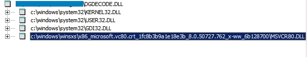

Consider also upgrading to the latest 2.57 of Avisynth. Make a backup of your Avisynth.dll in \windows\system32 and replace it with this one:
avisynth_257_latest.rar -
What the hell is msvcr80.dll and where do I put it? Does it go in the "\windows\system32" folder?Originally Posted by Soopafresh
Hee hee.
John, you have a way with words.... This is where it is located, but it ought to work just fine in the system32 folder under c:\windows
Hmm..actually, it might be better just to install the runtime library. Here's an alternate download location for it. Just unpacked the installer to make sure it was the real thing.
http://download.silicondust.com/vendor/dotnet/vcredist_x86.exe -
Google says:Originally Posted by FulciLives
From what a M$ man (Martyn Lovell) says (http://www.dll-files.com/dllindex/dll-files.shtml?msvcr80),msvcr80.dll is a process associated with Microsoft Visual Studio 2005 from Microsoft Corporation. It is the Microsoft C Runtime Library and is used by programs written with Microsoft Visual Studio 2005.
this file shouldn't be copied to any system directory, it should come with the application that needs it.
