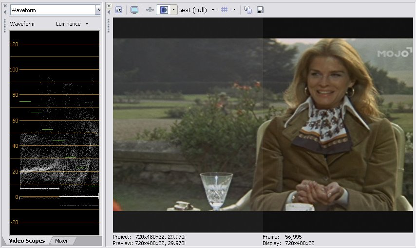

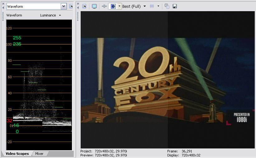

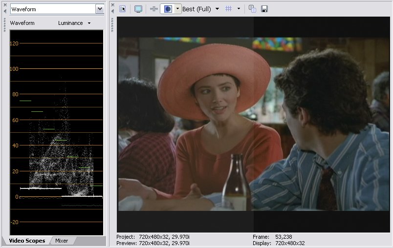

I haven't used the Pyro. I don't know if it has the setup switch or if it defaults to 7.5 IRE (digital level 16) when in NTSC mode. That would be OK since mine is always switched to 7.5 IRE. The setup compensation is necessary. See these samples. Level 32 black (aka washout) is on the left, 16 black is on the right.
These may appear dark on a computer monitor. Put them on a DVD and look at a TV.
DV format sample
ne-levels.avi -
