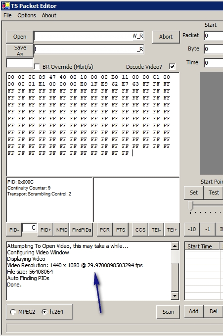

TS Packet Editor (TSPE) will display the info.

Thanks Soopafresh, I opened it and it has displayed the following info.
Displaying Video
Video Resolution: 720 x 480 @ 29.97000002997 fps
File size: 13344722972
Auto Finding PIDs
Not sure how accurate the info is though, as the video is actually 1920x1080, but being reported as 720x480.
