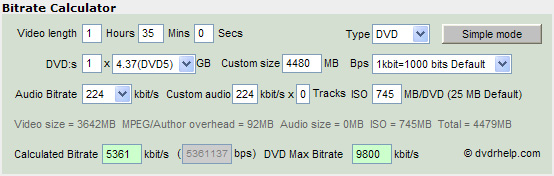

I entered into TMPGEnc a bitrate of 6096kbits/sec with a maximum bitrate of 9800kbits/sec because I didn't know what else to use and I didn't know the effect of guessing (too high or too low).
But the resulting movie was only about an hour long while the audio was more than two hours long, resulting in messed-up audio!

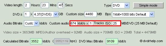

Given that input, here are the calculations (my sum of 202.2 + 471.8 = 674 kbits/s so that's what I used. I don't know where the 640 came from).
Do we finally have the bitrate calculation correct at 674 kbits/s * 1 track and an "ISO" of 25 MB/DVD?
Your bitrate is 3552 (check the bottom left), not 674. 3552 is a bit low, but won't send you oversized.

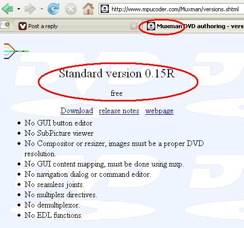

I suggest using a pure authoring program, maybe the freeware version of Muxman. I take it you don't care about chapters or subs or menus? Anyway, for Muxman, just load your pulldowned M2V video, your audio, and "Start". It may seem to die or freeze, but it's still chugging away. It'll pop up with a message when done. -

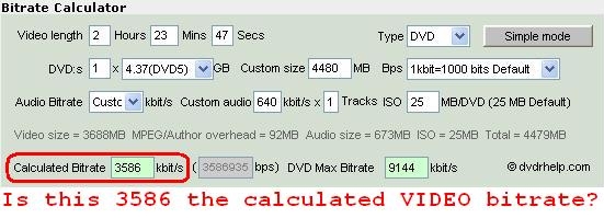

Aha! Finally I understand. Sorry for ditzing. I now understand most of the numbers you've shown in the VideoHelp bitrate calculator screenshot!Originally Posted by 45tripp
I guess where the calcuator says "Calculated Bitrate of 3586 kbps", it is talking about the calculated combined audio and video bitrate, is it not?
Anne -
3586 is the video bitrate you use in your encoder. If doing a 2-pass or multi-pass VBR then 3586 will be your AVERAGE BITRATE. You then have to select a MINIMUM BITRATE and MAXIMUM BITRATE. In this case I would probably pick 1000kbps as the MIN and 8000kbps as the MAX.

It was satisfying when the resulting NTSC DVD played in my hardware DVD player. The quality wasn't as good as I would have liked it. I wonder if that's because I used the exact numbers in John "FulciLives" Coleman's tutorial which were correct for his movie but wrong for my movie.
Remembering from my first post that I entered into TMPGEnc a bitrate of 6096kbits/sec with a maximum bitrate of 9800kbits/sec because I didn't know what else to use ... do you think THAT wrong bitrate is the reason for the low quality of my first results?
Theoretically, would the quality have been better or worse had I entered the "correct" bitrate of 3586kbits/sec and the maximum of 9144 kbits/sec into the TMPGEnc stage?
Anne -

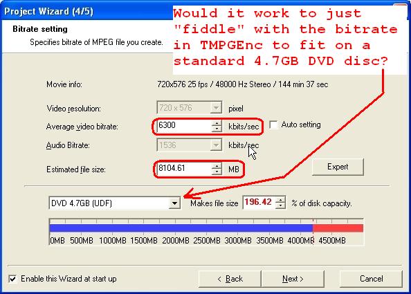

May I ask ...
Would it work to skip the Videohelp bitrate calculator in favor of simply fiddling with the TMPGEnc bitrate calculator so as to adjust the size of the video result to fit on a DVD5 DVD disc?
Anne
The bitrate calculator in TMPGEnc Plus works when you are doing the video AND the audio. However when doing PAL DVD to NTSC you don't do the audio ... you leave it the same way ... at least when doing the DGPulldown method of conversion.
The VIDEOHELP.COM Bitrate Calculator is actually very easy to use.
1.) You enter the running time of the video(s)
2.) You either enter the bitrate of the audio or you select "0" for audio tracks and put the size of the audio into the OVERHEAD area (next to where it says ISO).
3.) Make sure you also add some overhead to account for DVD Authoring needs. This goes in the OVERHEAD area (next to where it says ISO).
That's it. The bitrate reported is what you use as your AVERAGE when doing a 2-pass or multi-pass VBR. This determines your file size ... regardless of the MIN or MAX bitrates used.
Here is an example.
1.) The video or movie runs 95 minutes long (or 1 hour and 35 minutes)
2.) There are two audio tracks. One is a 5.1 AC-3 track at 448kbps and the other is an audio commentary track that is a 192kbps 2.0 AC-3 audio file. The two audio files add up to 545MB in filesize
3.) I want to do a fancy menu with motion chapters etc. so I decide I want 200MB for the DVD Authoring overhead.
So here is how you do it:
The 745 in the OVERHEAD area is simply the total of the audio files (545MB) plus the overhead I want for DVD Authoring (200MB). Notice I put "0" for number of audio tracks. Doing it this way (since we have the exact file size of the audio files) will give you slightly more accurate results and also makes it easy when doing more than 1 audio tracks (especially when the bitrate of each is different).
Anyways ... as you can see in my example ... the bitrate calculated is 5361kbps. So if you do a CBR that is your bitrate. If you do a 2-pass or multi-pass VBR that would be your average. In this example I would probably set the MAX at 9000kps and the MIN at 2000kbps (maybe less) if doing a 2-pass or multi-pass VBR.
