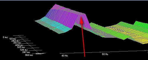

The first half-second of the sample says a lot as well. Here it is, exaggerated and looped. You'll hear the telltale 60hz grounding hum. (Not the part that sounds like House Music, but the ringing drone sound that you'd also hear if you ever unplugged an electric guitar from an amp)
groundloop.mp3
The same clip viewed with a frequency analyzer:
Here's a pretty good practical article on eliminating/reducing ground loops. I see your mic can use a 9 volt battery for power. Using that instead of external AC "phantom" power might be something to try.
