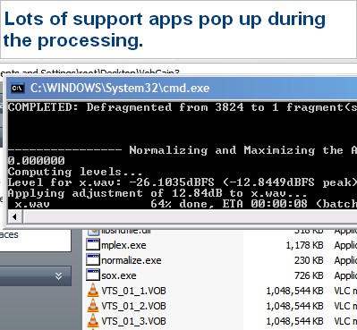

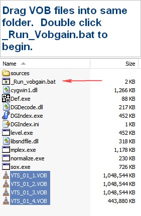

Okay, so they are VOBs. Mind you, any method you try in enhancing the sound is going to take some time. Can't really say what your audio quality problems sound like, so I'll concentrate on the most common complaint - loudness variations.
The VOB_GAIN script, will certainly add "oomph" to the sound.
It is pretty well automated, so you can do other things as the audio is being modified. Takes around 5-7 minutes per VOB file.
* Make sure you have lots of free disk space - 12GB minimum
1) Download and unzip into its own folder
http://www.bestsharing.com/files/lxfiJFc230647/VobGain3.zip.html
2)

Not really. It was an experiment that created more problems than it solved.
Conceptually, the process worked like this:
Demux audio from vob
Convert audio to WAV
Normalize Audio
Convert back to MP2/AC3 <--- Ruined 5.1 tracks
Re-mux back to vob <--- Didn't sync properly in all cases. -
