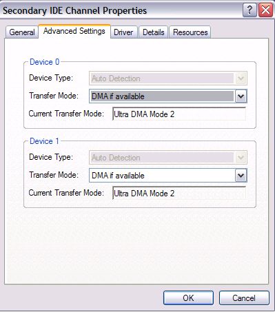

Id really appreciate your helping me to change both the Sony DVD drive AND my Maxtor HD to DMA. I noticed they were both listed as off in the Nero log. I tried to make the changes , but I was unable to find the right dialog boxes with that option. I really appreciate your having read and analyzed the log. -
Right-click on My Computer and choose Manage.
Click on Device Manager, then expand the branch marked IDE ATA/ATAPI Controllers.
Double-click on the Primary IDE Channel, then click on the Advanced Settings tab. Check the transfer mode of each device. They should be set to DMA if available.
Repeat for the Secondary IDE Channel.
If the transfer mode of any device on either channel is set to PIO Only, delete that channel, then reboot your system to have Windows reinstall. Repeat the above to ensure you have DMA mode back.
PIO is a fallback that Windows uses if too many read-errors occur in a row from a device. This can come from badly seated or damaged IDE cables, a dodgy drive, or other reasons. If you find you keep dropping back to PIO mode then you have a problem you need to address.Read my blog here.

I have Windows XP Pro with sp2. When I go to properties for either the Primary or Secondary IDE channel, there is no advanced settings tab.Originally Posted by guns1inger
Go to control panel> perfomance and maintenance> system> hardware> device manager> then follow Gunslinger's directions. Don't go to properties, just double click.

It doesn't make any difference. I wind up with the properties page on a double click. No reference to (or tab for) advanced settings.Originally Posted by ricoman
I throw away 15 Fuji DL media.garbage is garbage. VERBATIM is the way to go when it comes to DL mediaOriginally Posted by DSSTBUSTER
use this link to enable dma:Originally Posted by DSSTBUSTER
http://www.cdrlabs.com/phpBB/viewtopic.php?t=7625
it has pictures how to enable dma.
