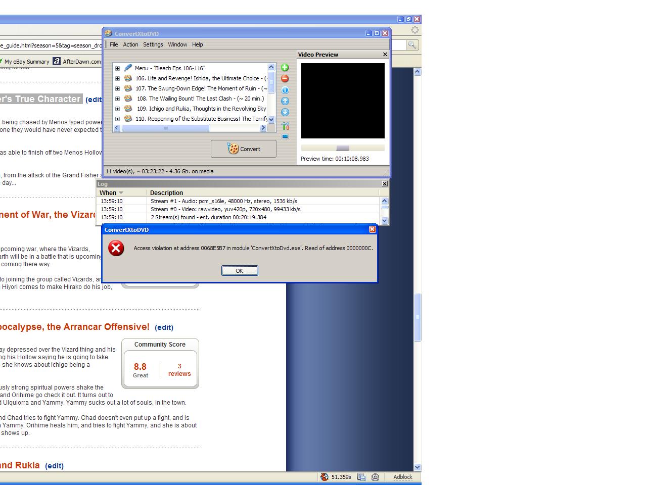

Error Message I get when Trying to use ConvertXtoDVD...

This isn't authoring, I'll move you to Newbie Conversions.
Your SUPER settings are fairly close, though I wouldn't use MP4 format video. If you want to use AVI type formats, I would use DV or Huffy, if you want minimal quality loss. But the files will be very large. SUPER doesn't have a lot of choices. Or you could just do a direct conversion to MPEG-2 with 48Khz AC3 audio. ConvertX should accept any of those formats.
Since you are asking about Anime, if those are PAL formats, I wouldn't convert them to NTSC with SUPER. Just keep the same PAL framesize and Frames/Sec. ConvertX can handle the PAL>NTSC conversion better. -

Convert XtoDVD does not handle rmvb files. You would be better off searching for new copies of whatever you are trying to convert in an avi format. Real media files are crap and they never seem to convert to well. Winavi can handle rmvb files so why dont you try that.Originally Posted by sandman423

Hi,
VSO ConvertXtoDVD can convert Real Video 8,9,10 by adding a few .DLL in the path of ConvertXtoDVD.exe
http://www.portmac.com/modules.php?name=Downloads&d_op=getit&lid=197
to download them.
Latest version of ConvertXtoDVD is v2.1.19
v2.20 ßeta is due soon, with more features like "Deinterlace" but haven't seen it yet.
