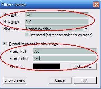

i want to add some effects to a small AVI file (2 minutes)...
so i looked for filters and found some Here and Here.
there are a lot of great filters there.
but i couldent find a filter which i can add borders with it.
and i dont mean top and bottom borders,
i want to add left and right borders as well...
does anybody know where i can find it?

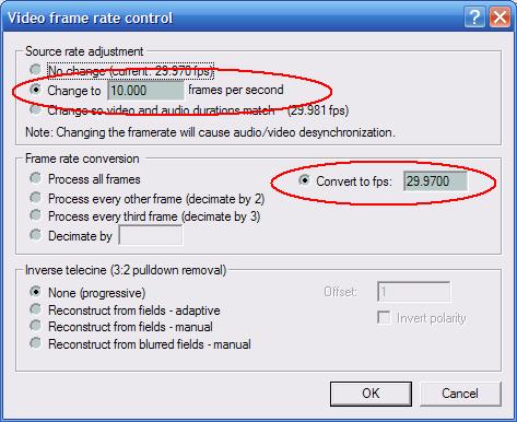

i'm also want to add a slow motion effect - how can i do that?
THANKS!!!
AFAIK, the resize filter lets you add borders all around.
/Mats -
Use the Resize filter to add borders:
And you can use the Framerate adjustments to slow down a video. Maybe not the best way, but easy. Lower the 'Source rate adjustment', then restore it with a 'Frame rate conversion'.
