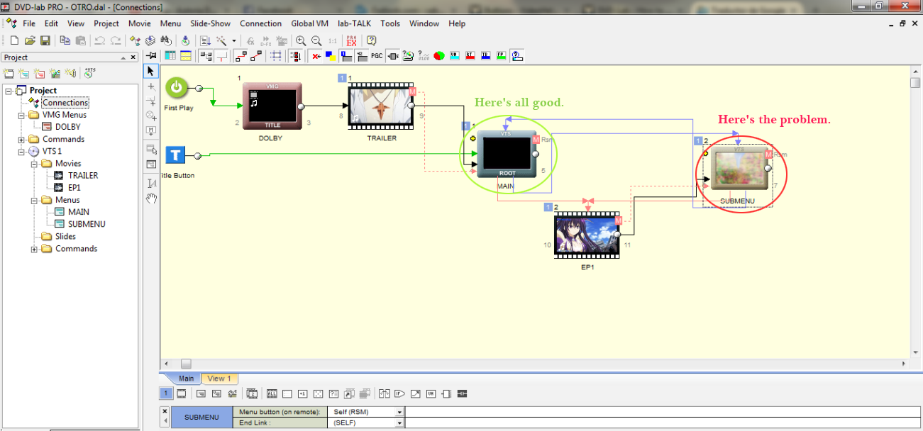

  5. Just guessing, that sometimes, you want to jump to cell 1 and sometimes to cell2.
    It is all controlled by that GPRM0 value, if you want to jump to cell1 again you just have to set GPRM0 to zero (non 1 value) somewhere along the way, after clicking a button, or in some pre-command section ...

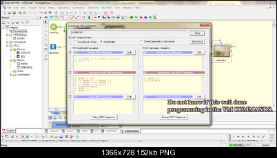

    I leave some images as it is structured and scheduled. As long as topology and SUB MENU.
    01.- topology

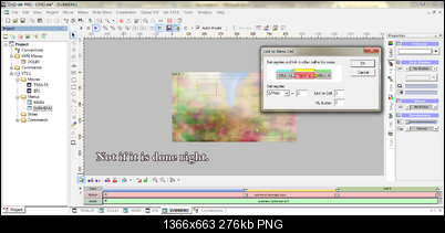

    02.- SUBMENU - REGISTER
Name:	02 SUBMENUREGISTER.png
    03.- SUBMENU - VM COMMAND (PRE COMMANDS)
Name:	03 SUBMENUCODE.png
    I await your prompt response and thanks for the help.
    Sorry my bad english XD...

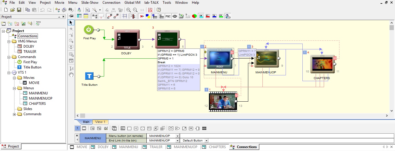

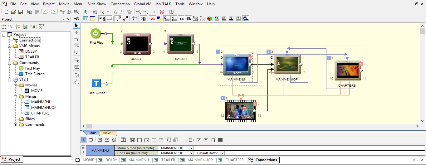

    Hello again, and look for the solution to this problem. Thanks for the help.
    Rather I have another problem, but almost reached the end.

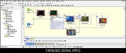

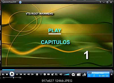

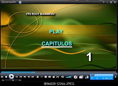

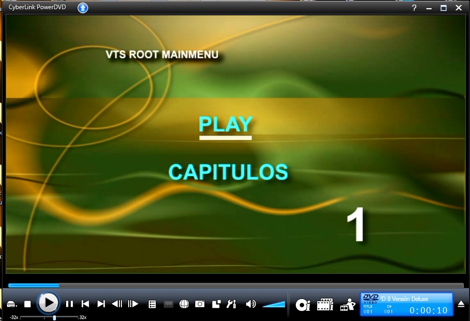

    Look, here is a picture:

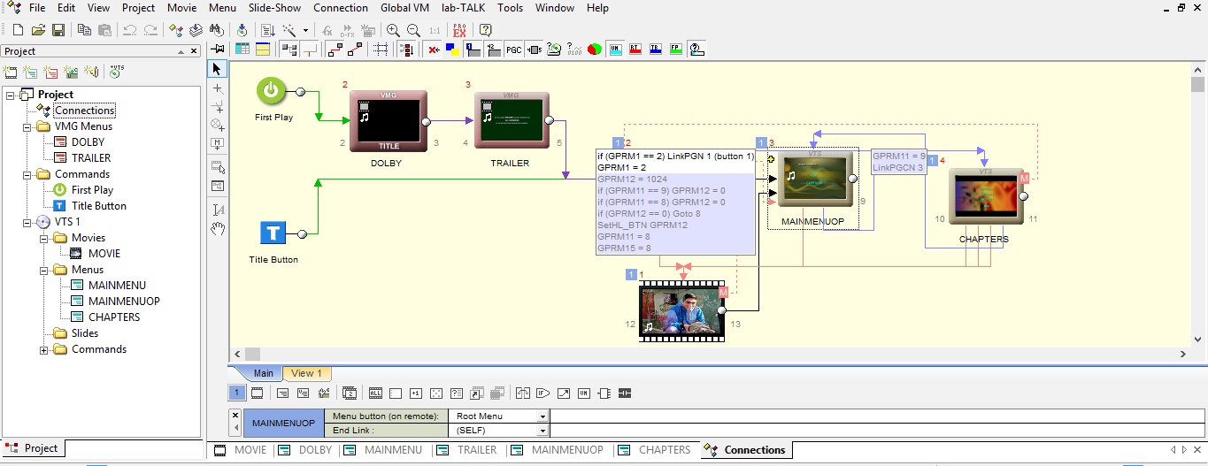

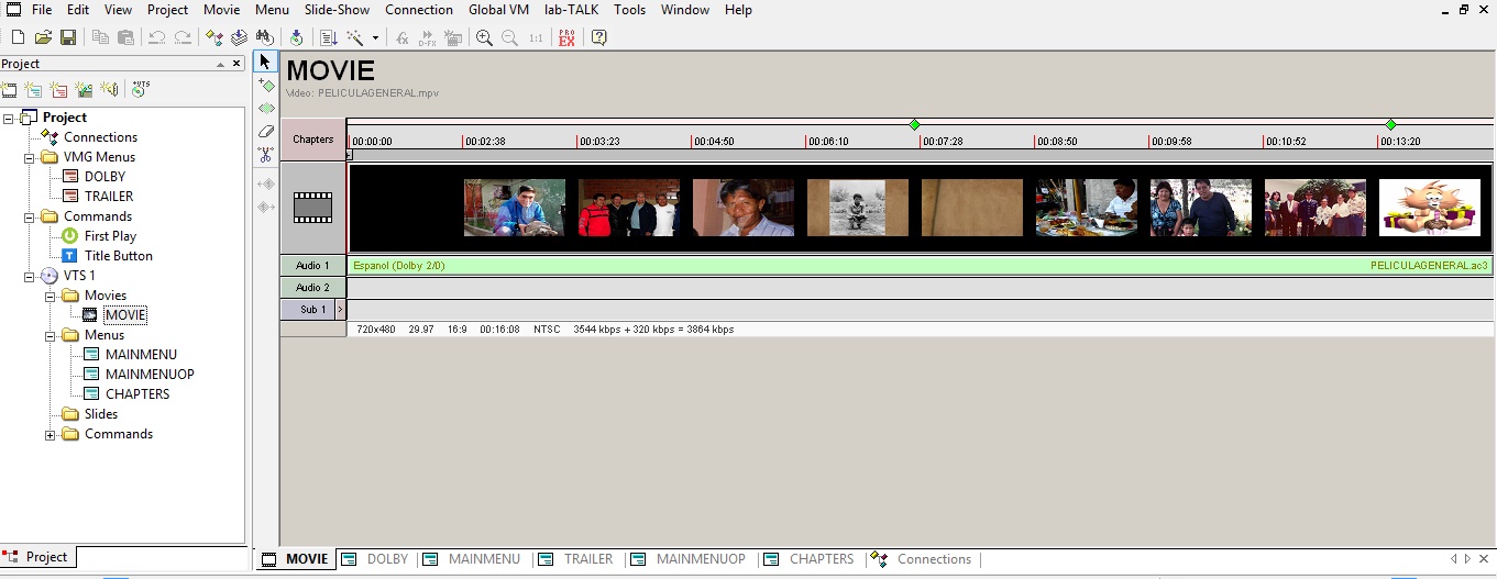

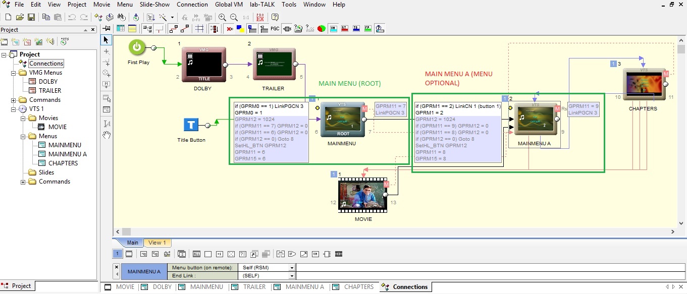

    Within this topology:
    VMG = DOLBY
    MOVIE 1 = TRAILER
    MOVIE 2 = MOVIE
    VTS ROOT = MAINMENU (BUTTONS PLAY and CHAPTERS)
    VTS 2 = MAINMENUOP (BUTTONS PLAY and CHAPTERS)
    VTS 3 = CHAPTERS

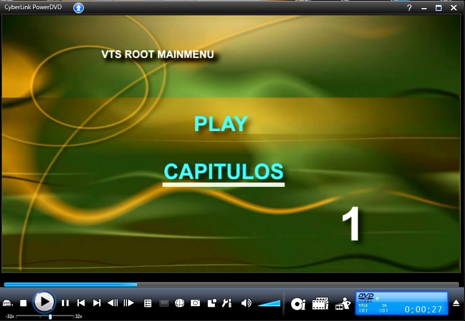

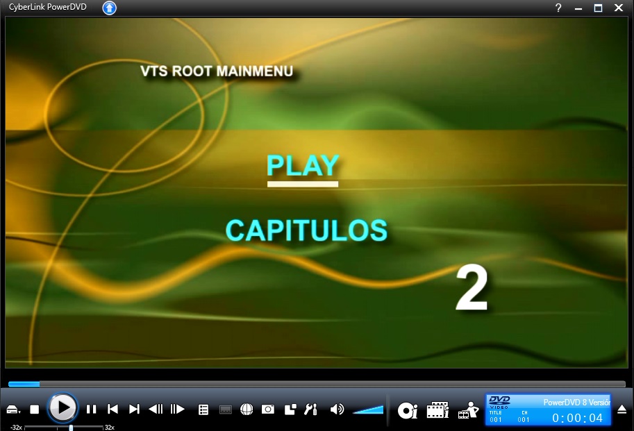

    I'm working with the "LINKPGCN" command to call a "VTS" and is almost similar to the programming of the cells.

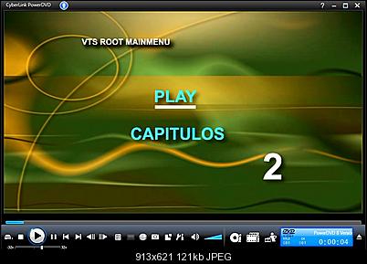

    The good news is that with this configuration, in both PC Media Player Classic and CyberLink PowerDVD 8 me works perfectly and smoothly on what the "TITLE Button" and the "MENU Button", but instead on a DVD player Normal. Just run one "MOVIE" seen in the topology, when you return to the menu and returns press any of the buttons (TITLE and MENU BUTTON), goes in either "MOVIE".
    Well here's configuration:
    Here it is on the "SHOW PGC" tool

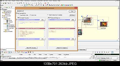

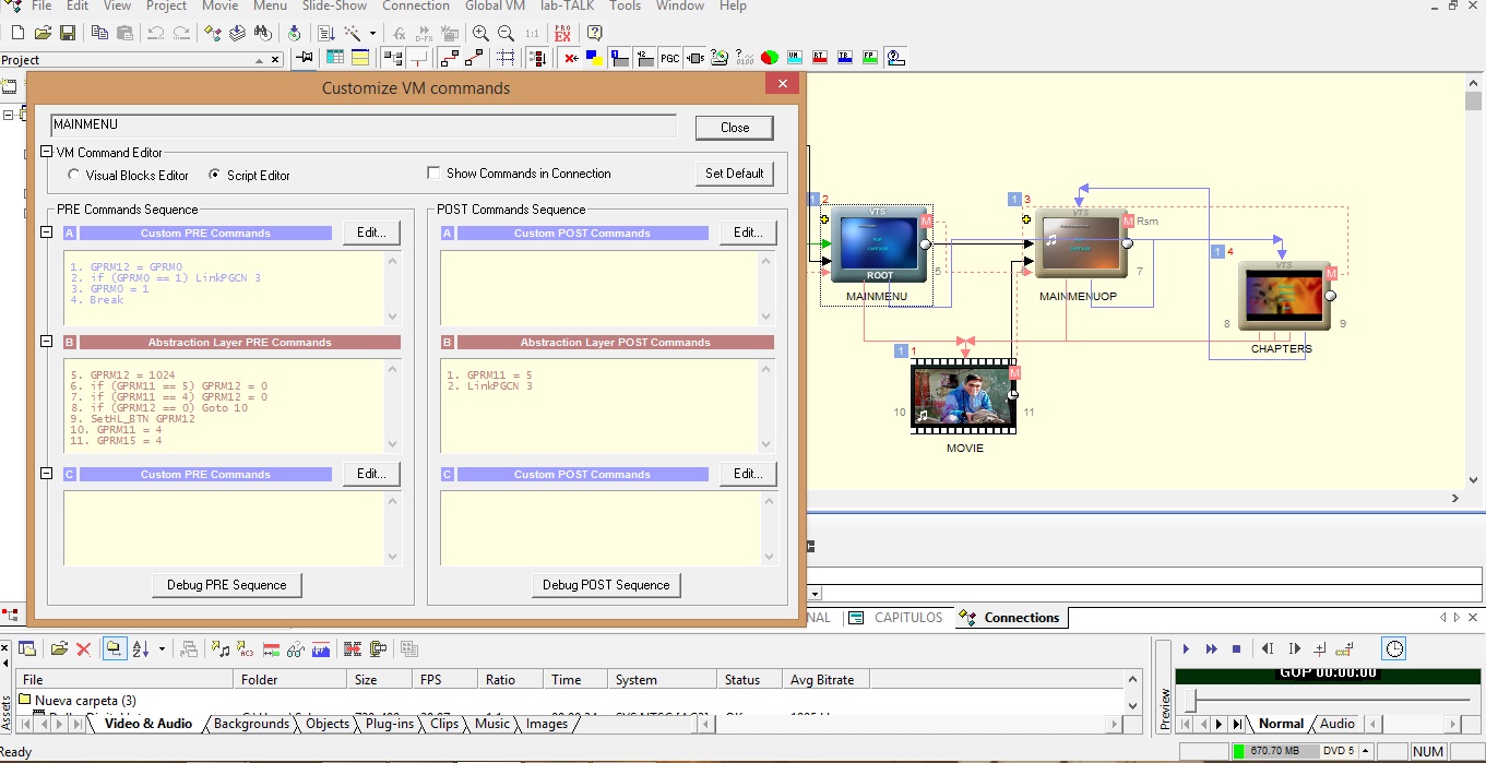

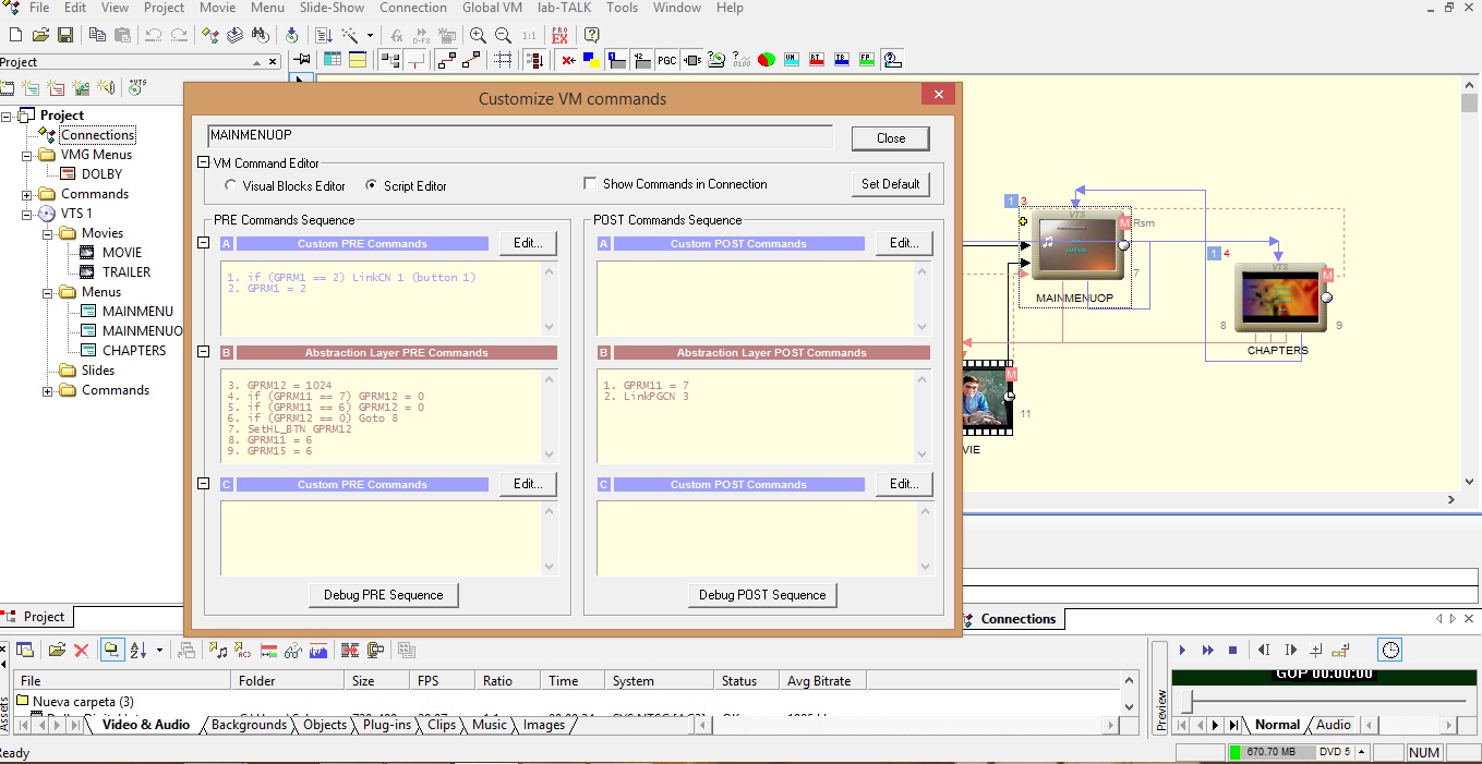

    Here programming:
    I do not know if I can say what is wrong and I can solve this problem in detail. Sorry my Bad English XD... and once again thanks for the help.

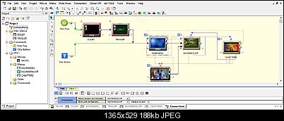

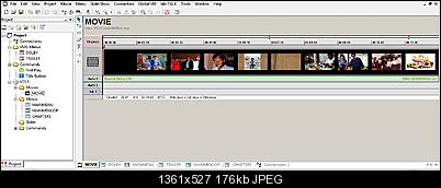

  10. before any attempts to do some scripting I'd reorganized that structure, it looks kind of messy, I'd make it easier for any player, maybe that will solve your problem right there
    -put that trailer into VMGM or another VTS, do not keep it in the same VTS like your main title is in
    -not sure, why there are two play-chapter menus, that one, kind of main one, again not sure why it is there, I'd get it out of the way also, by putting it into VMGM

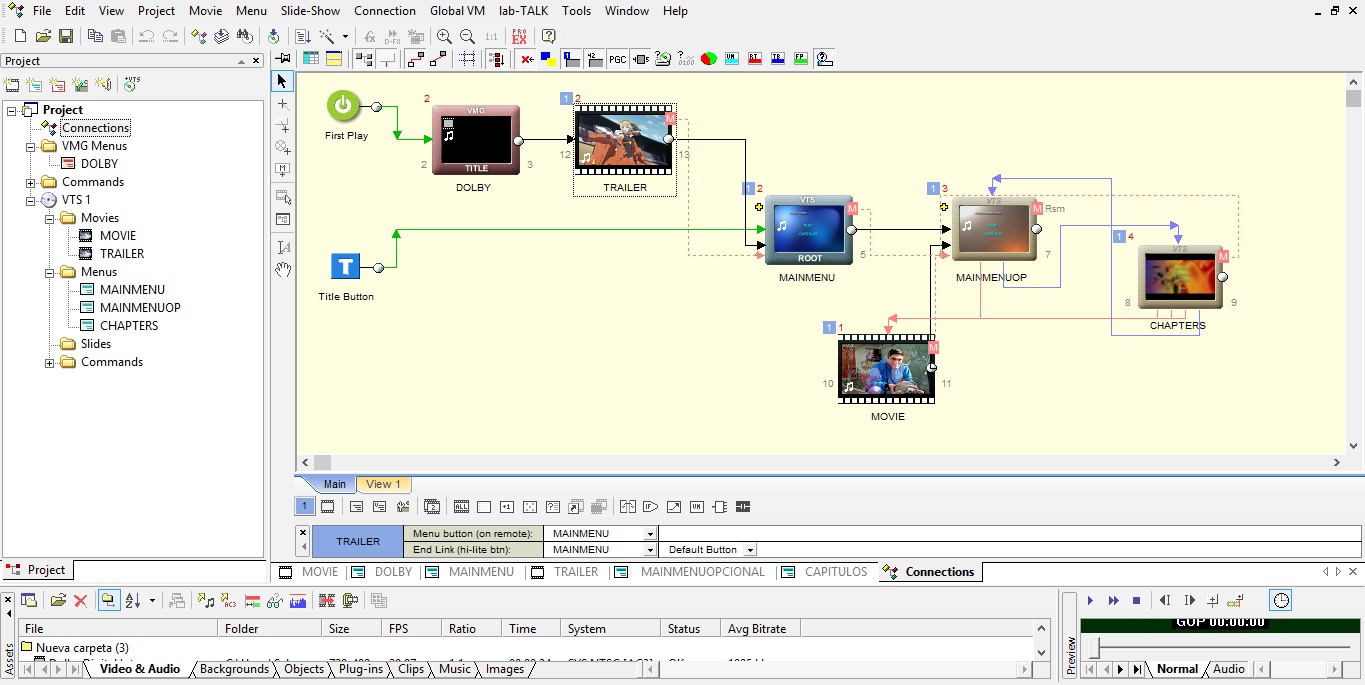

    Aug 2014
    lima

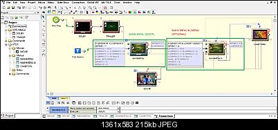

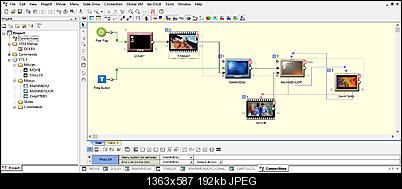

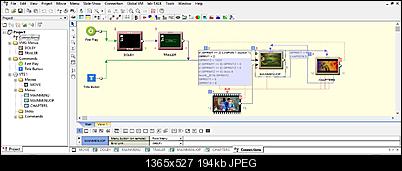

    Hello again, well, I've structured topology, there is a part that told me to put it in the TRAILER VMG or VTS. In VMG is ok, but in a VTS? A button to go to the Main Menu, which will not work without a button is needed, and worst case I can not use the "RENDER MOTION", as it is a 5 minute video.
    Now in the Main Menu I have linked to a VTS, and you said to put a VMG, that thing that there are problems in connecting and encoding of a VTS ROOT to a VMG MENU, and that makes me more laborious and very difficult to so, instead a VTS MENU, if you can, since I have tools available to put as connection or coding.
    topology:

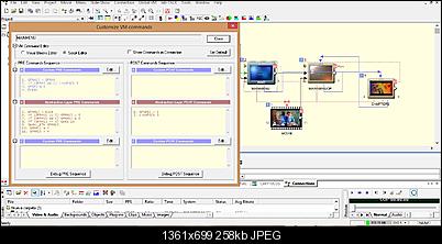

    MAIN MENU (code)
Name:	TOPO02 - PROMAIN.jpg
    MAIN MENU OPTIONAL
Name:	TOPO03 - PROMAINOP.jpg
    Another thing, if I put a VMG menu for the "chapters" in "MOVIE", I have divided into "chapters", as seen here in the picture.
Name:	TOPO04 - MOVIESUBDIVI.jpg

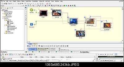

    The trouble is that when you link with chapters, does not leave me time that has divided the chapters in "MOVIE" is displayed only the beginning.
    Now I've changed the VTS by VMG for TRAILER, and have changed the programming in the COMMAND (PRE COMMAND). So you can see if it's right or not, or what is missing (The first image and two others.).
    What does the biggest problem is when I go to the main menu either buttons (TITLE or MENU BUTTON), in that part all OK, that is first directed to ROOT and then the VTS, but enough that the film starts and return back to the menu and retighten the TITLE or MENU button returns back to the movie where he was playing, he is not in the same MAINMENUOP, unless the MENU or TITLE button is pressed again.
    Overall is summarizing the movie, and I do not want it that way, I want only that directs me to MAINMENUOP either buttons (MENU or TITLE BUTTON) simultaneously.

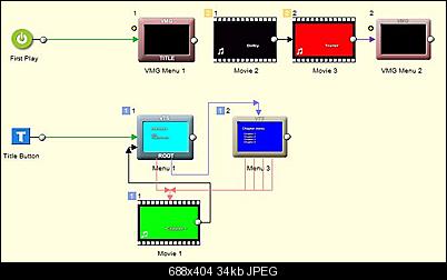

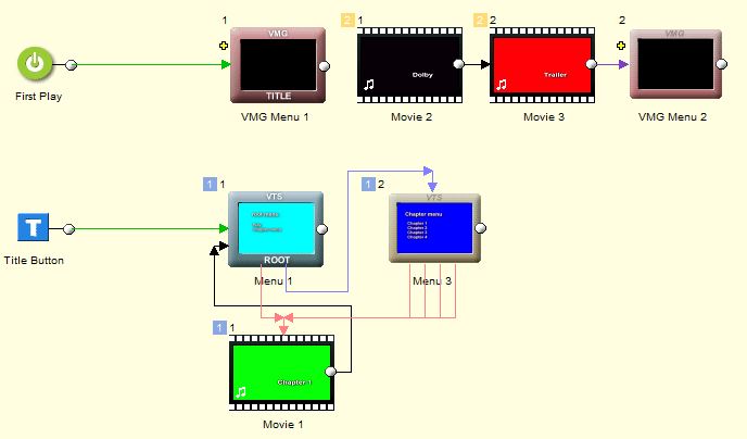

  14. look at this project, there is all files, VIDEO_TS and even DVDlabpro project, so you can download that and test it yourself,
    that is how I would set it up:
    (I forgot to delete that default title VMGM menu, so you can delete it and go from first play to Dolby-Movie2 clip right away)

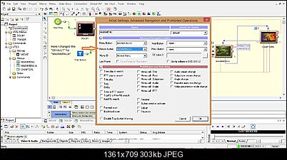

  15. Member Skiller's Avatar
    Oct 2013
    Germany
    Whilst in any menu the push of the Root Menu button will do a Resume. This is normal and often locked out with PUOs. It's like an invisible Resume button. The push of the Title Menu button will either call the Title Menu or Resume as well (unless prohibited). In a software player such as PowerDVD this can be executed by pressing L and then selecting Resume.

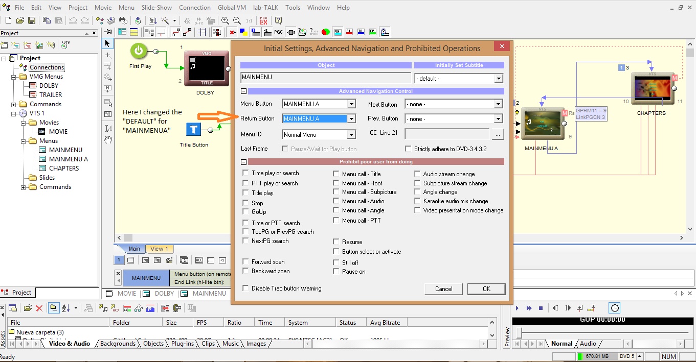

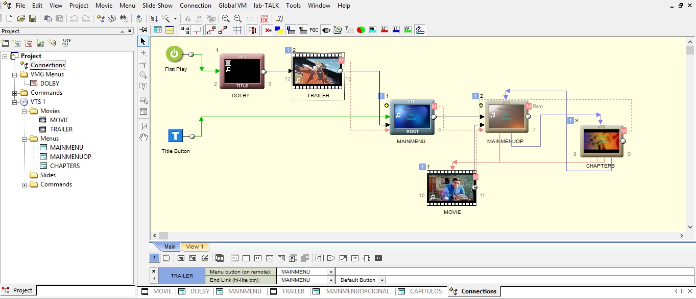

    Hi, I served on the part of the FIRST PLAY, but what is in the ROOT MENU, but you do put one VTS, what should be 2 menus connected and codified in the VM COMMAND as I mentioned earlier.

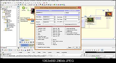

    Rather, it was investigating the commands to improve my project, and come to this conclusion as shown in the image:
    This makes me either the execution to go to the main menu and then the optional menu, pressing the Menu or Title button.
    AH !, What if I did not say is that within each menu put music to both the main menu and the other optional. Imagine is an animated menu.
    Other have also cloned the ROOT Menu, and as seen in the picture above this as "MAINMENU A". With this, I thought it was going alright, but not in coding everything is ok, only made me a summary in the film when I press a second time either MENU or TITLE buttons.
    The Skiller friend said something to the ban on VTS, movie, etc. The only thing that has worked for me is if the box "RESUME". But the trouble if predicament for the second time either MENU or TITLE buttons is disabled. Suffice to different button is pressed but not the same, rerun the optional menu, as well as playing PING PONG.
    If any box other than "Resume", what should be.

    Another thing that was watching, is about links containing the ROOT VTS Menu and Menu option, do not stay in place when handled. For example, when the link is up and down, when entering the menu option automatically sets this up, do not stay in the position has been desired. It would be good, that command can add or create a VM COMMAND to remain in the desired position.

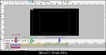

    A crazy idea would be that if you can restart a cell, for example, I think three cells, the first cell is the INTRO, the second is the appearance of the selection buttons (PLAY and CHAPTERS) and the third I put an animation apart of the radio buttons, you can copy and paste. Now in the third cell animation starts from zero minutes to finish, say, ending the thirty minute and then restart again (LOOP) and so constantly 0 minutes.
    When I did so, it automatically gathered the minutes with the above cells, that is, when it reaches the third cell is not put to zero minutes if there continued to follow the minutes until the end and then restarted according to the encoding to since.
    The question is: Is that possible to do? You can create a VM COMMAND ?, and if so, as you would? ..
    Here a picture for you to understand better:
    Well, hopefully you can help me on this, much like you and also the friend Skiller, thanks anyway. Sorry My Bad English XD
