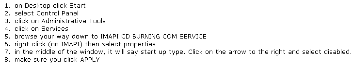

	I just had to bounce this post, just in case anyone else has encountered this issue. I spent the better part of my morning burning 13 audio CDs of old-time-radio broadcasts for an elderly friend. And out of the first 6 attempts, 3 CDs garnered the Nero "power calibration error." And while Nero may point the finger elsewhere, I found a solution to the problem (at least on my system using Nero 6.x with WinXP). It came from a post made to another forum in 2004:
 I applied the fix ... and the remaining 7 CDs burned without a hitch. Can't argue with success.
