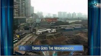

    Is this what you are trying to do? If so you composite your 4:3 image over the 16:9 background of your choice.
