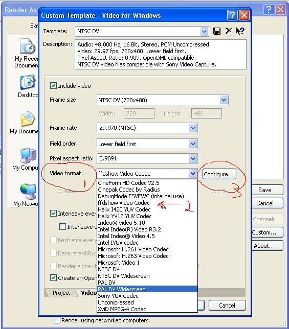

How do you use ffmpeg to render out of Vegas? [/quote] -
you can encode to any resolution, just select custom and set the resolution ... they are not limited to 640x480 (a least the mc codec)
for ffmpeg -> select avi and then custom - then select ffmpeg or other choices from drop down list ...

I still haven't found how to use ffmpeg though. It just doesn't appear in the list of encoders when I select custom AVI. How do you "register" ffmpeg with Vegas?

I still don't understand how I can render in Vegas with the standalone Main Concept H264 encoder or ffmpeg? When I choose ffdshow as the avi format, the only codecs that I can configure are the libav codecs. No H.264 or AVC.
