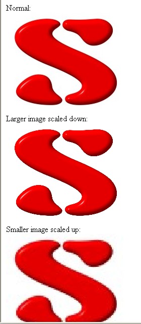

    That will work however it will produce aliasing around the edges of images that have been scaled down and "macroblocking" if that is correct term for images that have been scaled up. The degree of aliasing or macroblocking really depends on the original and the size you are going to. The aliasing affect can go from unnoticeable to extreme. In the following example it's moderate.
    These are all screenshots from a webpage. the first image is dispalyed at it's native size. The second one is a larger imge scaled down by the browser. the last one is a smaller image scaled up by the browser. All in IE6, not sure if IE7 or FF handles scaling better.
