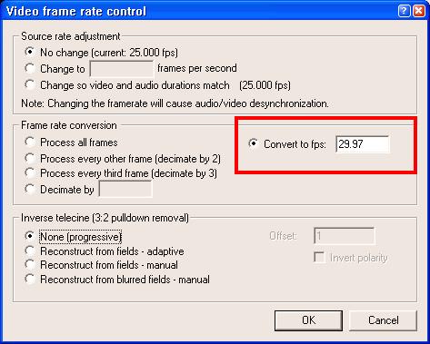

Just reading your message now, I try change from 25.000 to 27.970 does make audio out of sync. What can I do to overcome this? Which tool can I use to convert video 25.000 to 29.970? -
With avi files, no. You can re-encode and have extra frames created to get the framerate up, but you will get jerkiness, and you will have to adjust the audio.
If you were doing this with the ultimate aim of going to DVD, then there are other alternatives. The simplest is not to join them, but to encode at NTSC resolution and PAL framerates, then use DGPulldown to add the requisite pulldown flags to get 29.970 fps playback. You could then join them during authoring.Read my blog here.
If the intro isn't critical you can just use VirtualDub's frame rate conversion function. It will simply duplicate every 5th frame (except every 1001'th) to convert 25 fps to 29.97 fps. This will show up as 5 little jerks every second but depending on the nature of the video you may not notice it. Then encode with the approprite codec and settings.
The intro only have music, no vocal. I covert it to 29.970 with virtuadubmod and it seem to work ok, video syncED. I finally can join it now....
