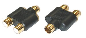

  13. If the projector has an s-video input you could use your existing component cabling with a pair of s-video "breakout" adaptors:
    http://www.avcable.com/Merchant2/merchant.mvc?Screen=PROD&Product_Code=SVHSB&Category_...=S_VIDEO_CABLE
    http://www.hometech.com/techwire/coaxconn.html (near the bottom of the page)

  18. Originally Posted by puzzledbytech
    I'll have to add a female BNC to male RCA adapter/coupler for each of the wires because my inputs/outputs connectors on the component cable are female RCA plugs.
    My second link earlier led to small adaptors (HT720) that go straight from s-video to female RCA. They might be easier to deal with.
