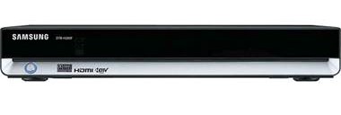

Unfortunately, I just have a HD-Ready HD set - no build in tuner... But if the OTA signal would be much better, I'd consider buying an ATSC digital tuner... What're the cheapest ATSC tuners available? Is it the "digital is digital, and perfect" kinda thing, or are there differences in quality between tuners? -
Chicago, IL - OTA
http://www.avsforum.com/avs-vb/showthread.php?p=9948893#post9948893
I got this box(i got it $25 cheaper with googlecheckout,and it was $169 at that time)
Samsung DTB-H260F High Definition Terrestrial Tuner
http://www.jr.com/JRProductPage.process?Product=4144839
http://www.amazon.com/Samsung-DTBH260F-HDTV-Terrestrial-Tuner/dp/B000JV6TQY -

This ATSC receiver is one of the better receiver. Does any big box stores carry this model ?
http://www.jr.com/JRProductPage.process?Product_Id=4144839&JRSource=googlebase.datafeed.SAM+DTBH260F

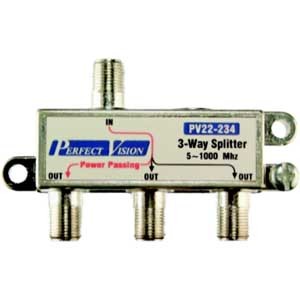

I read many users has to rotate their antenna to get to the stations. Why not use a few antenna and a splitter as a combiner ?
Antenna combiners are a different type of device. See Channelmaster or Wineguard.
http://www.warrenelectronics.com/antennas/Jointennas.htm
http://www.tvantenna.com/support/tutorials/combining.html
http://www.terrestrial-digital.com/antenna_recommendations.html -
Passive RF components are bi-directional.
For Analog TV signal, band pass filter is most likely needed.
Mutli-path ghosting is a analog TV only issue.
With DTV signal, the receiver should only work on the strongest signal. -
Originally Posted by SingSing
"Mutli-path ghosting" is an analog issue but multi-path reception interference is very much a problem for ATSC. This has been a major problem for early ATSC tuners in metro areas or around tall buildings. Combiners that RF bandpass filter are equally important for digital TV and they aren't that expensive.
