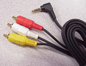

My next step will be to get the audio working. The camcorder (Canon) has an 'A/V Out' port which seems to be the only way to get the audio from it, so I suppose I need a cable arrangement that will ignore the video portion of that and feed the audio into the Line In port of my sound card. Hopefully WinTV2k is able to take video from the Hauppauge card and audio from the sound card and put them together. -
Camcorders usually use this type of cable for A/V Out:
http://www.radioshack.com/product/index.jsp?productId=2404389
You should be able to use the s-video cable for video, then just connect the red and white cables to the PVR-250 for audio. The yellow cable carries composite video but that is lower quality than s-video. -
