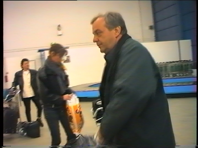

    I've got two VCRs and I made some screencaptures for comparrision.
    I am interested to find out which of those tow (JVC HR-S9600 & Panasonic NV-FS200 (AG-1980) is the better VCR for digitizing old material.
    On first glance you can see that the JVC has a smoother picture with less noise. (DNR was off) Where the Panasonic has more noise, but also more details.
    I cannot say if the JVC just used a softening filter, if the Panasonic uses a sharpening filter or if it really gets more details.
    Anyway:
    Which VCR should I use for digitizing old VHS tapes?
    Which one will be the better if I intend to do some editing.
    Having HD in mind: Which one wil look better resized on an HDTV.
    A general discussion about the samples pictures would be greately appreciated.
    How would you describe the quality of the two VCRs in technical terminology?
    Thanks!

    JVC, NOTBC, NODNR
    Aug 2006
    Germany
    PANA, TBC, DNR
    Aug 2006
    Germany
    PANA, TBC, NODNR

    There is more detail in the Panasonic images. The JVC image looks soft in comparison. For example, the squares in the the gray tiled wall (upper right) can be distinguished on the Panasonic, while the vertical edges of the tiles have been lost on the JVC. Detail in the man's face and hair, and all around the carousel has also been lost on the JVC.
    Based on these images, I would use the Panasonic. No contest.

  6. i couldnt agree more, the JVC basically washes all the details off the image, and for having HD in mind, it would make it the worst viewing pleasure to the human eye.
  7. I don't think you indicated which "picture control" setting you used for the JVC.
    I'm assuming you used "Auto" (the default setting).
    Try changing it to "Edit" (through the menu button) and you will get a much sharper image output (but possibly also more noise).
    I only use the Edit mode in making my digital transfers on my JVC HR-S3600U. I would rather have more detail and get a little noise, than have a smoothed out picture. But other people are really bothered by noise. It's the great trade-off in VHS capturing.

    The JVC picture setting was EDIT.
    Well, I suppose that to compare those two is more a religious debate.
    The way I see it is: Do you like filter to soften the picture (JVC) or are you a purist and want it with all the noise.

  11. i would recommend the Panasonic, as it keeps all the detail, and thus my theory would be to do that and use latest software to help do htr job properly.
    one example i would use is Neat Video, which i think is the BEST noise reduction software ive seen. yes i know people claim it being slow, but once u use it on a P4HT or Core 2, u will be abit suprised.
    and ur scaling, i would suggest InstantHD.
    together combined, u cannot tell what source it came from.
    i am looking for a mahine myself htat will scrape every single detail off a VHS tape very clearly in order to work with. like proper tracking, stabilized image and fantastic connections (S-Video of course).
    i hope that helps.
    Sounds reasonable. Does anybody want to give a counterstatement?

    The Panasonic RULES in this category. I have tried several tapes that have stability porblems (not a constant shaking, but rather a sporadic collapse of the complete picture for a frame or two). The JVC was not able to do much with those tabes. But the Panasonic plays them without sweat. (keep in mind that I am using a canopus ADVC 300 on both)
    Question: Is this because of the better TBC (half frame?) or because of better drive/head hardware in the Panasonic? Would buying a full TBC (Datavideo TBC1000) help to get the same stbility on the JVC?
    anyway: The Panasonic RULES in this category.
    Well one could argue that the JVC is doing HARDWARE-WISE what a SOFTWARE-WISE filter will end up doing. So if you use the JVC you can skip using a software "video noise" filter.
    Of course the "flip side of the coin" is that if you use the Panasonic you might be able to filter with software and clean up some of the "video noise" but in such a way so that you still have "more noise but also more detail" compared to the JVC processing.
    In other words the Panasonic with a software video filter might give you an in-between image. One that is cleaner than the Panasonic is (before the software filter) but not as "soft" as the JVC image.
    - John "FulciLives" Coleman
  14. well, i took the liberty of taking one of the images (PANA, TBC, DNR) which i think is the better one, and made into an uncompressed AVI, where i imported it and did some processes on it.
    this would be applying InstantHD, at 1080p with full quality, anti-aliasing, and sharpened abit. and at the best quality setting.
    after that, i applied Neat Video, where i quickly and carefully adjusted it to make it look good and again exported it to an uncompressed avi and took one frame from it to get the image, thus here it is:

    Nice image, Undead Sega.
    Accurate tracking and detail reproduction are mainly functions of the "VCR" (Heads, Transport and Signal System) and not the "TBC/DNR".
    I doubt that a TBC1000 will provide the same stability on the JVC. Nothing will bring back the detail that has been lost. Noisy detail can be filtered downstream, but once its gone its gone. IMO, the JVC takes too much away.

  16. So, for those of us that crave detail, don't mind a little noise, and whose sources are in pretty good shape, perhaps the answer is a quality older VHS deck.
    As luck might have it, I just picked up the great-grand-parent of the AG-1980, a Panasonic PV-S4764, a S-VHS from 1987. No question of any digital noise reduction softening the picture in this one! It has a nice manual soften/sharpen knob. It's working fine and the picture output, especially through the S-Video connection look good. I'll be comparing it to the output of my JVC on various tapes.
    A final thought on the noise versus clean signal split. Perhaps what underlies this is the source material that one spends the most time converting. If you convert animation, there's nothing more irritating than seeing those chroma noise streaks across blocks of color. But if you convert films, there's nothing more annoying than seeing the loss of detail in close-ups of the face.

    One other thing, ive owned a AG-1980 as well as two JVC SVHS such as the 9600 and I have to say I prefer the playback picture from the JVC SVHS units over the ag-1980. The AG-1980 is a great deck and has a better tbc but picture wise, I think the Jvc produces the better picture with the tbc/dnr in use, when it comes to vhs tapes.
    An older S-VHS deck, I would say.
    The move to HDTV makes the preservation of detail that much more significant. The softening effects of mediocre playback performance, DNR, Half D1 capturing, etc. are all more noticeable (and more objectionable, IMO) on a higher resolution display.

    Haven't read all the posts yet, but in goes my 2 cents. I've been wondering if my Panasonic NV-HS860 (2002ish) was as good as the NV-FS200(1994). And looking at these really useful pics I think its the same. Unfortunately if you look at the skin tone of the man (I always look at the face first to compare) the Pan is a little sicker looking, just like mine does. Now which one is right, should have a bit more colour or not? I'm starting to think I like more colour and softness. There really is no pleasing some people
  20. Member StuR's Avatar
    Sep 2006
    jabweb, had a better look now.
    I did the usual and set up a photoshop layered pic to compare the 3 and one thing I noticed is pic 2 and 3 both pana are the same i.e. the NR is not on. I think you need to avoid the edit option as that usually cuts out all picture processing. Edit setting is really for the days of SVHS>SVHS dubbing as the tape was going to soften the quality in the dub. As DVD is sort of lossless (in HQ anyway) it will copy what you see so I'd suggest not using edit and maybe just a bit (say 15-20% on the dial) softening too. That should give you the best off both worlds.
    I think JVC is increasing the colour saturation, or contrast as the white background wall looks pinker and the mans face is probably a bit flushed. JVC is too far one way for me but the Pana is showing to much the other way.
    I'd be interested to see the results.

    Think I've come to a decision, looking at Undead Sega's ver. of the Cap.2 (which definatley is the same as the other one Cap.3 - DNR isn't on) it's much improved as it softes the origonal sharp/grainy image. So a DVDR which softens the Pana image is the ideal combo then? That means JVC for both VCR and DVDR has got to be overkill. Looking at the pic. in Photoshop the JVC can be corrected to the Pana by reducing the Red (RGB image using histograms). Thats why the JVC looks so rosy. You'd get used to it but looking at the two side by side thinking 'which one would look more real if I was say watching this as a news clipon TV' the Pana looked like real footage and the JVC looks a bit weird.
    A close up of the face on 'Undead Sega's' and the JVC shows the detail that is lost, if the VHS is then binned then it's lost for ever. not happy about that.
    But these are only stills I prosume moving image can be prosumed the same thou.
