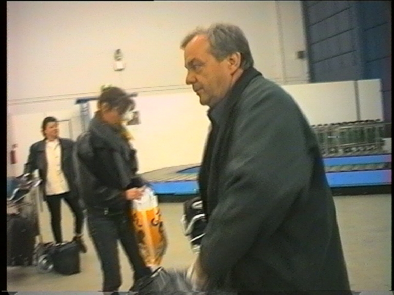

Great image Fulci. It's really easy to see noise on a low-depth background. All that "detail" is grain -- it's not supposed to be there. Splotchy chroma too, another issues myself and others have noticed on Panasonic machines.

It did on the first set of images in this thread. The large tiles in the upper right look like large rectangles on the JVC because their vertical edges have been lost. These edges are not noise. They are detail, and they look too far gone on the JVC to be recoverable.Originally Posted by robjv1
Like the others here, I see no difference in detail on Fulci's images, and prefer the 7600 image. There is too much noise from the Panasonic, which doesn't even seem to be tracking properly.Life is better when you focus on the signals instead of the noise. -

I think this image looks best. You can see the stubble on the man's face. ----- With the JVC version, the stubble disappears which is loss of information, and speaking as an engineer, I HATE losing information in my signals.Originally Posted by fabweb
Okay. Thanks for the suggestion. Now where can I find "Troy in 1985, age 13" on Bluray?Originally Posted by deuce8pro
Please point me to the relevant store. 'k' thanks.
(point
(A lot of these tapes we are transferring are only available on VHS or Super vhs, and that's why want to preserve as much detail as possible.) -
That's not stubble! Not unless his coat has stubble too!Originally Posted by theaveng
You're confusing generated noise with "detail". Stop it.Want my help? Ask here! (not via PM!)
That's not film grain. That's MPEG2 compression that leads to macro-blocking. My copies of Star Trek DS9 have the exact same flaw in dark scenes.Originally Posted by sanlyn
That's a flaw of digital video, not the film. -
Black noise? That's a new one. Okay. How about the tiles in the background? In the JVC they are all blurred together, but in the Panasonic you can see the individual squares.Originally Posted by lordsmurf
Clearly the Panasonic has a wider horizontal bandwidth (resolution). The OP didn't use a chart, but I'd estimate the JVC is only putting out 2.7 megahertz (subpar) while while the Panasonic is providing a full 3.0 megahertz bandwidth per VHS spec. -
