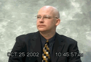

Here's an example:
http://dts8888.com/vDTS/vdts.htm
nothin better...you can choose font, etc.'Do I look absolutely divine and regal, and yet at the same time very pretty and rather accessible?' - Queenie -
