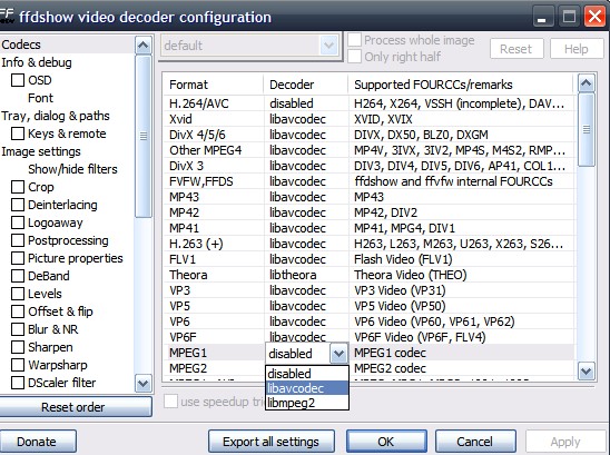

You can install ffdshow to get that functionality back. It'll support most file types, including the ones you mentioned.
Get the clsid build
http://sourceforge.net/project/showfiles.php?group_id=173941
After installing, you'll be presented with video config screen. Turn on support for Mpeg1 like this:

Okay... Downloaded FFDShow as mentioned above and restarted computer... When I look in configuration, MPEG1 & MPEG2 are NOT listed. I'm assuming here that those codecs are therefore not installed and probably the associated audio codecs that go with them. How can I check? What am I looking for? Am quite comfortable working with Windows so could probably install them manually if need be. TIA
