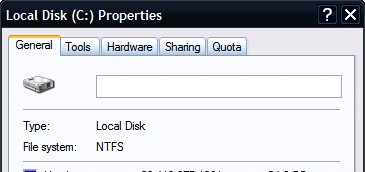

    Okay, I checked my drive's format, and it is indeed NTFS, so at least there's that. I had no idea that there was a 4 gig size limitation on video files. But anyway, here's where I'm at so far:

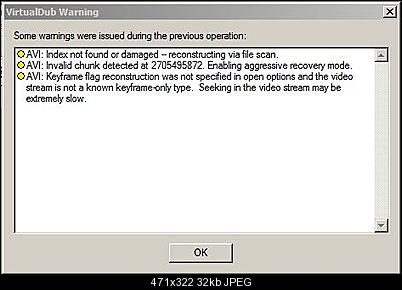

    I opened the video with VirtualDub, and it gave me a few warning messages:
    AVI: Index not found or damaged -- reconstructing via file scan.
    AVI: Invalid chunk detected at 956934288. Enabling aggressive recovery mode.
    AVI: Keyframe flag reconstruction was not specified in open options and the video stream is not a known keyframe-only type. Seeking in the video stream may be extremely slow.
    Honestly, I have no idea what any of that means, so maybe you can help translate it for me. Also, when I ran Virtual Dub, it recovered a few minutes toward the end of the video (concluding with the 45 seconds I'd already managed to get). What's strange is that when I opened the file in VirtualDub, its window that says "reconstructing missing index block" skipped ahead to about 3.75 gigs into the video. Now, I've never used this program before, and so I was wondering, is there a way for me to get it to at least try reconstructing the first 3.75 gigs and show me what it has, even if the video playback may have tons of glitches?
    Also, you suggested using a program to break it up into smaller chunks, less than 2 gigs each. Since I'm new to this kind of thing, is there a program you would recommend that would be able to help me do this the most effectively?
    And thanks for all the help so far. If I can just recover a bit more of the video I'll be incredibly happy!

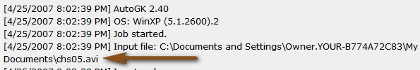

    Okay, I tried using AutoGK on the file, but it doesn't seem to have worked. I set the predefined size to 1493mb (I hope it wasn't a mistake to do that), but when I clicked preview, it said this:
    [4/25/2007 8:01:12 PM] AutoGK 2.40
    [4/25/2007 8:01:12 PM] OS: WinXP (5.1.2600).2
    [4/25/2007 8:01:12 PM] Job started.
    [4/25/2007 8:01:12 PM] Source resolution: 0x0
    [4/25/2007 8:01:12 PM] Source fps: 0
    EXCEPTION: No frames are found.
    [4/25/2007 8:01:12 PM] Job finished. Total time: 0 seconds
    Of course, I hit preview before telling it to add the job, so maybe I made a mistake there. I don't know. But I added it as a job anyway, and tried to start it, and it said this:

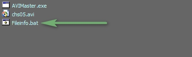

    Download this file and unzip. Place the two files in the same folder as your chs05.avi file.

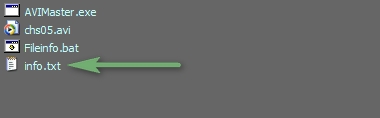

    Double click fileinfo.bat to run, it'll create a file called info.txt. Open in notepad and paste it here.
    fileinfo.zip
    Apr 2007
    Wow, that gave me a really strange info.txt file. It simply says:
    AVIMaster 1.4.2 (c)2004-2006 by thozie productions, Thomas Ziegler, München
    Contact and Bug Reports: www.thozie.de/dnn/AVIMaster.aspx, avimaster@thozie.de
    No files to process found.
    What the huh??

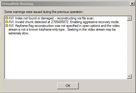

    Oh god, I have this very same problem as well. Was recording for 4 hours or so straight on CamStudio and when I saved the .avi nothing can read it. I'm at my wit's end because that was a hell of a lot of work just gone down the drain...
    Anyway I was recording using "MSU Screen Capture Lossless Video Codec" (haven't had any problems with it so far). The file is 29171300ms long, 30fps, and 3.22GiB. As oversized as it is I wasn't running out of space in my temp folder when I recorded it, and for the record it's NTFS. But this file isn't 4gigs!... So I've tried a number of things
    1. GSpot says it's got a corrupt video header (Details: While processing chunk /RIFF:AVI, found bad length value 192 at file offset 0x00000010 - same thing as what LPrime got) The running time is pretty screwed up, I know I recorded for ages but not 8 hours.
    2.And I got pretty much the same error as LPrime when opening it up in VirtualDub-MPEG2, just that the chunk number is different.

  28. Old thread but I got across this problem too, corrupt CamStudio captured file, Huffyuv (via ffdshow) over 2GB .
    VirtualDub fixes that file while loading, gives a message:
Name:	virtual dub warning.JPG
    I exported uncompressed out (for video editor) and everything is fine.
    Any file over 2GB is corrupt from CamStudio v2.00.
