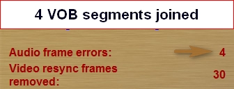

    I'm starting to think it has to do with the joining of the VOB segments. The more VOBs joined, the more out of sync it gets by the end. Especially things that get progressively worse. It should be around the 20-22 minute mark(s) that the sync goes out of whack.
    Each dropped audio frame = 31.25ms
    00-21min = perfect sync
    22-44 min = 31.25ms skew (1st VOB join)
    44-66 min =62.50ms skew (2nd VOB join+skew from 1st join)
    66-88 min =93.75ms skew

  5. I'm starting to think it has to do with the joining of the VOB segments. The more VOBs joined, the more out of sync it gets by the end. Especially things that get progressively worse. It should be around the 20-22 minute mark(s) that the sync goes out of whack.
    That's the problem I'm facing. What I'm looking for is method to keep the audio and video in sync. I would need to cut out part of the video because the video is ahead of the audio. I think I can use VirtualDub but I'm not sure, and I'm not sure how hard it will be to get it in perfect sync.
