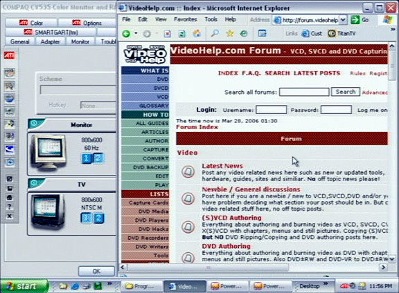

You need to assign the overlay to the S-video monitor. This is done in different ways with different chipsets.Originally Posted by mikehende
Here is how it's done with the older control panel for ATI chipsets. S-Video is given the #1 priority. This frame was captured off the S-Video port so is representative of S-Video quality.
