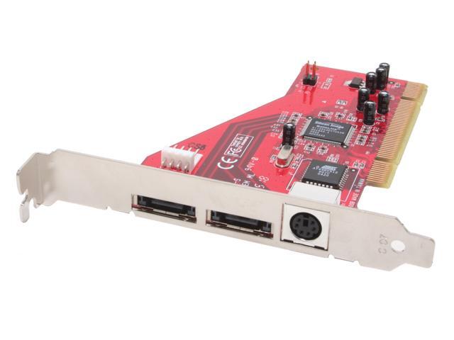

eSATA card
http://www.newegg.com/Product/Product.aspx?Item=N82E16815123016
Otherwise USB2 is plenty fast for PVR use. -
