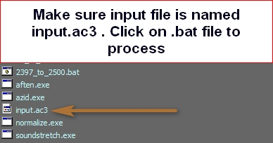

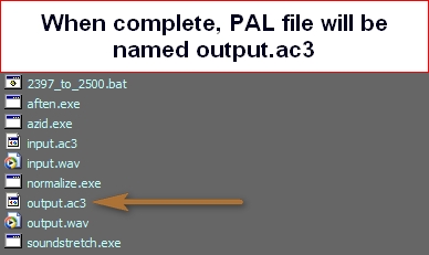

    Is it a 5.1 AC3 track or 2.0 ?
    Here's an easy way to do 2.0:
    Download the following
    23_to_25.rar
