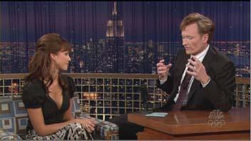

It shouldn't be pixelated but it is 720x480i interlace. Sure you aren't just seeing field lines?Originally Posted by maxxDV
A raw view of 16:9 DV (or DVD 16:9 MPeg2 for that matter) should look full height and horizontally squeezed like this.
720x480
When played to a wide TV or in a software player it gets stretched out and looks like this.
853x480
