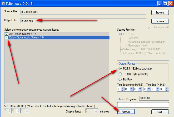

Download TSREMUX and generate a new file, use that file as your source. That should take care of the discontinuity errors. Also, the "ChangeFps(29.97)" line might be messing with the sync, so leave it out. However, KEEP the 29.97 portion in the DirectShowSource line. BTW, you DID turn off the deinterleave setting in ConvertX, right ?

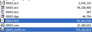

1) Create AVS file from MTS input using avchd_convert_v5

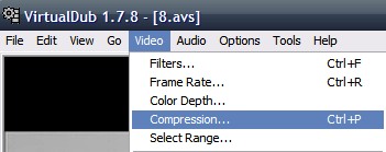

2) Open up AVS in VDub
3) Save raw AVI as output
4) ... and here I need help ...
Thanks guys. I appreciate your time. -
Install Xvid https://www.videohelp.com/tools/XviD_Codec

Probably better if you encode to a lossless format like Huffyuv and feed the resulting AVI file to ConvertXtoDVD. Download the following zip file and add it to the existing AVCHD convert folder, it'll automatically transcode the AVS files to Huffyuv AVIs. Make sure you have lots of free disk space.
huffyuv_addon.zip -
"Make sure you have lots of free disk space."
Any ballpark number as to how much free disk space for a given file size we're talking about(?) Tell me it's not the aforementioned 40x...
Thanks. -
10X. It's temporary, just until you're done encoding to DVD.
