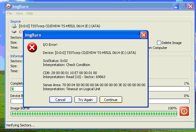

    I'm trying to burn dual layer dvd's. Yesterday, the burner created $7.99+tax worth of 3 DVD+R D/L coasters .
    #1 - I zipped thru ImgBurn to create a D9, but verify failed .
    #2 - I rechecked my settings, tried again, but verify failed again .
    #3 - I went and got the guides from the ImgBurn burn forum, followed them to the letter to make sure my setup was correct, and tried a third burn. Again, the burn appeared to go smoothly until the verify step where it again failed . This time I took a screen shot of the error message.
    Anyone got a clue for me as to the problem??? The dvd drive specs are for DVD-R DL Write Once - 4X and DVD+R DL Write Once - 2.4X .
    David
    PS - If I click 'continue', it comes up with the same error with the next sector , ad finitum.
