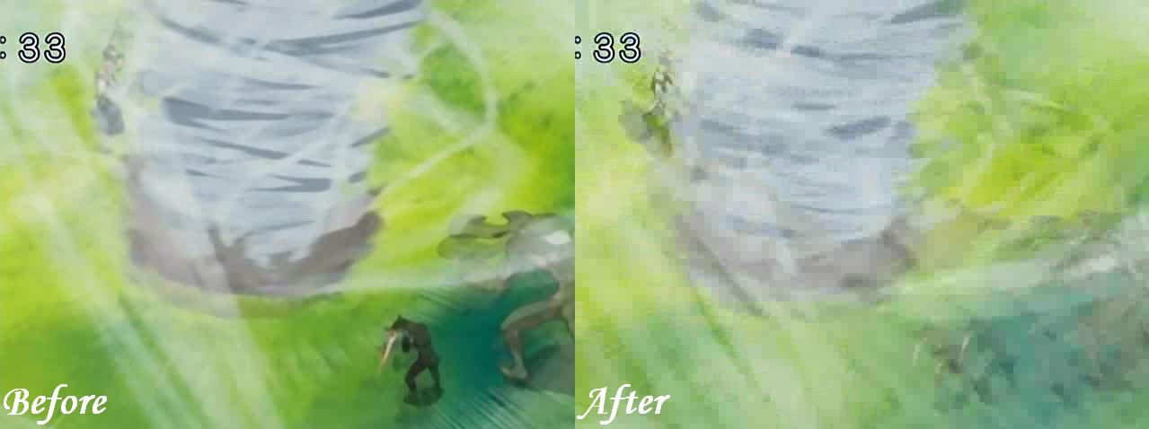

  1. Hi I am trying to fit several episodes of an Anime onto a dvd by cutting intro and outro out but I stumble across quality loss. Is there any method that I can use to avoid quality loss?
    Like for example if I convert the XviD file to uncompressed first then re-compress it?
    * Tried using VirtualDub wouldn't work, tried with several settings, when I finally manage to get same quality output the file was bigger even though there was no intro and outro. Also some settings gave me an error.
    * I tried using MediaCoder but same results as VirtualDub.
    (Attached a comparison picture)
    Please help me find an answer to this.

    The "After" picture has been deinterlaced. Don't do that.
    Describe your source (G-Spot) and process.
