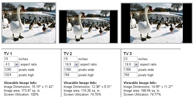

A 19" 16:9 wide monitor will have much smaller type vs. a 19" 4:3.
To match height (type size) you would need a 23" wide monitor.
http://tvcalculator.com/
If I was going to replace one of my current 19" SXGA 1280x1024 monitors,
it would be a 23" 16:9 to match type size. To match 19"resolution,
I'd want to go with native WSXGA+ 1680×1050 or better for the 23".

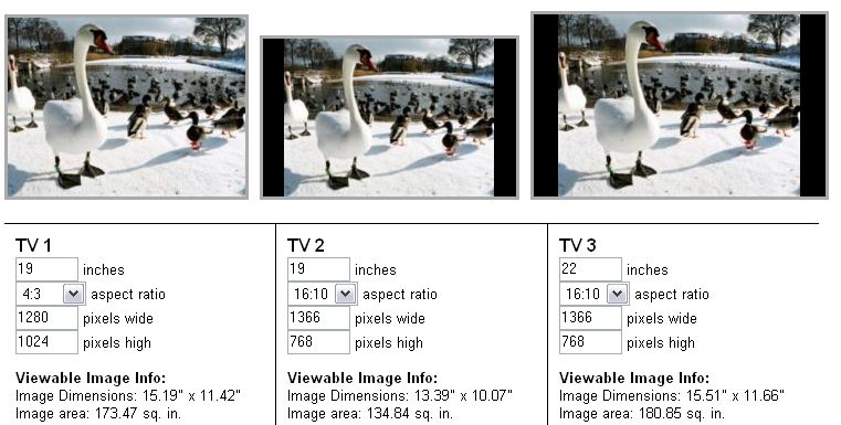

Here is the calculator output with the more correct 16:10.
The wide equivalent is now 22" rather than 23".
The Samsung 225bw 22" (1680 x 1054 native resolution) is a near exact
match for type size to a narrower 19" (1280x1024).
