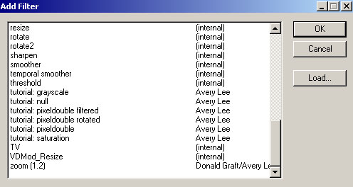

As you're using VDMod, there should be 2 resize filters, called "resize" and also "VDMod_Resize".
If you DO need to resize then the VDMod_resize filter has more options than the plain vanila "resize" filter. -
VDMod_resize doesn't come with VirtualDubMod. You have to download and install it.

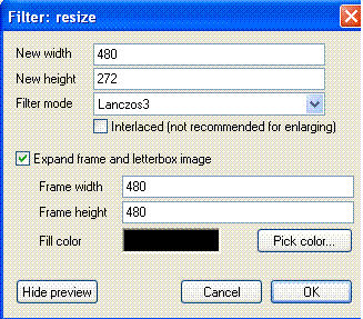

taking your video going to 4:3 mpeg ntsc SVCD
you need to resize to 480x272
and add borders.
With vdub you tick the 'expand frame...' box and expand to 480x480
there's an app called avi resize calculator
to help you resize avi to dvd -

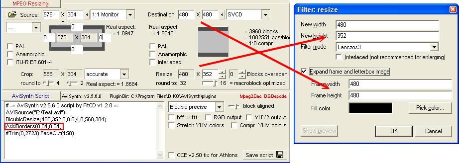

Use FitCD to calculate the resizing parameters. Use the middle "MPEG resizing" section. -
jagabo, first of all, thanks man! really appreciate it!!!
is this the calculated size? the destination size?
did i miss something? -
Below where your picture is will be the AviSynth script. There will be an AddBorders line that will tell how many pixels of black are needed to pad out the resolution to 480x480. And you do realize that you're adding black to the sides and more than necessary to the top and bottom by having 2 blocks overscan don't you? The effect is also to lower the resolution. I don't know why that guy makes 2 blocks overscan the default. Unless you need it to make low subs visible, I'd set the blocks overscan to 0.
2 blocks in the default because many users of FitCD use it to bring subtitles back inside the overscan area because fan-subbers have no idea where subtitles should be. If you have badly positioned, hardcoded subs then you should leave it at 2 blocks.
2 blocks is also a good size when upscaling for DVD full-D1, as it reduces the amount of resizing without making visible borders (on most TVs) and the cost of the black to bitrate is minimal, so more goes to the image.
It is only when working with the stupidly low resolutions of VCD and SVCD that it becomes an issue.Read my blog here.
When using VirtualDub to resize, you add borders using the "Expand frame and letterbox image" section of the Resize filter.

do you mean this?Originally Posted by manono
where do i need to add those values?

The blocks add the borders, top and bottom, and left and right. If you just resize to put borders top and bottom then you screw the aspect ratio. If you use the 2 blocks borders scripts in avisynth then you get the correct image size and aspect ratio all in one go. And ConvertXtoDVD will encode from an avisynth script so you can use it to get the correct image. FWIW, ConvertXtoDVD does not zoom images at all.

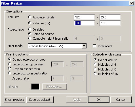

I installed the Aud-X version of VirtualdubMod and it does come with this resize filter. It comes with a few other filters that don't come with Virtualdub or VirtualdubMod.VDMod_resize doesn't come with VirtualDubMod. You have to download and install it.
Here is the resize filter that comes with Virtualdub 1.7.2

Eh? You're saying that script in FitCD will wind up giving him bad aspect ratio if he then encodes for 4:3? You're saying the only way to get good AR is to add blocks? I must be misunderstanding you. Sure, he might lose some picture to the overscan, but so what? This isn't the ConvertX Zooming thread.Originally Posted by guns1inger
to fill out the frame use the "Expand frame and letterbox image" section of VirtualDub's Resize filter:
Or install AVISynth, use the Save Script button in FitCD to save the AVISynth script, then open that AVS file in VirtualDub (AVISynth will handle the resizing via the script). -
