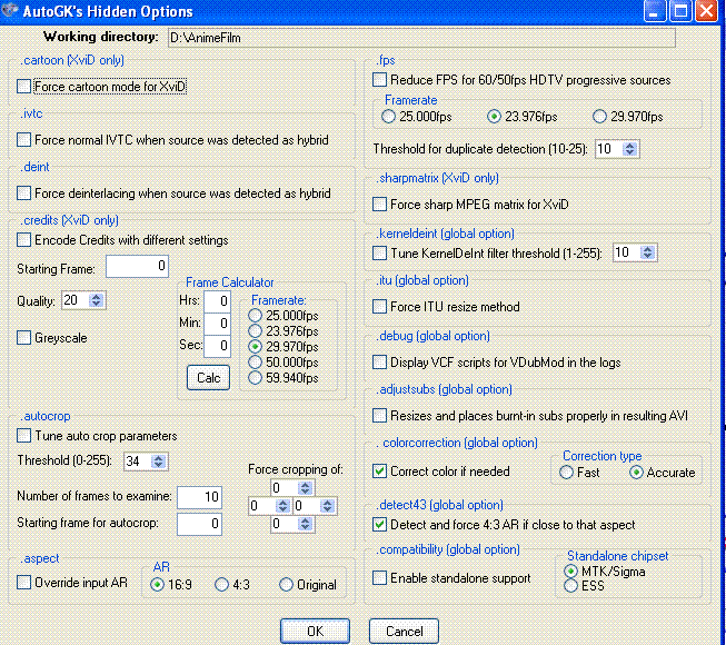

I think it depends on which chipset ypur standalone player have. My player for instance does not like more than one consecutive BVOP so the setting above may not work. I think that you should try the home theater profile in XviD. Another option is to convert to DVD Video format.
That's a thinko, not a typo, on my part. It comes from never having used it at all and no doubt remembering MMC from the days when I used to use an ATI card for video capturing. My mistake.Originally Posted by jagabo
It's in AutoGK not Dr Divx.Originally Posted by ispy
Once you input your source press ctrl+F9 to get to secret settings
there's no need to unpack if you are going to re-encode.Originally Posted by ispy
