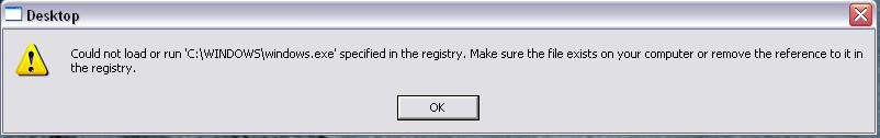

    Since couple of days I have problem, as I start the system after boot, these messages appears. I am not very good understanding computer problem. Please do help me and let me know how I could resolve the problem. Thanks. Here are the screen shoots.

  4. There is no official Windows component called windows.exe - so, clearly there is something nasty going on (and Google does indeed suggest it is a trojan...)
    However, the messages state that it is missing - which is probably a good thing.

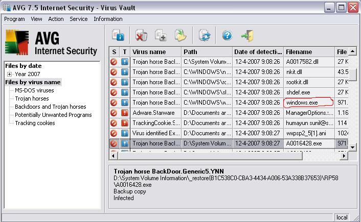

    i did check all registry, couldn't find any thing. I have Avg 7 internet security, its find something name window.exe, but when i try to find the location i wasn't able to. here is the screenshoot of the avg scan result.

    I did have AVG from long time, yes it had remove the threats, but then why the message appeared in the start all the time?
    how could i stop it??

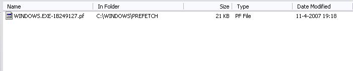

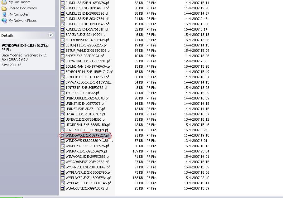

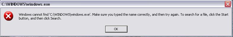

    thank you guys, here are new development, i try to search windows.exe in start>search>type windows.exe. the search result shows the finding. And i also try to locate it in in c:\window\prefetch\windows.exe
    you will see search screen shoot and path screen shoot. Please let me know it is worthwhile to delet from the path location? or any other best to do??
    here is search screeshoot
    here is path screen shoot

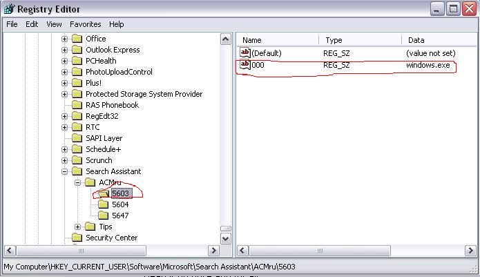

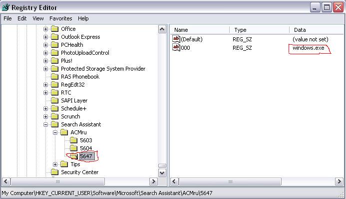

    i think i also find it in registry editor, but i seen it in two different locations. what should i do now? do i have to delete it from registry or path location?? need your help.
    here are first location
    Here are second location

    Those are only the searches you did. Some info is on the drive and the registry keeps a copy of recent searches. You can delete them all but that's not what you need to find.
    There are a few locations where shortcuts can be activated in the registry. The first location to check for the entry you want will be found in HKEY_LOCAL_MACHINE\SOFTWARE\Microsoft\Windows\Curr entVersion\Run or HKEY_LOCAL_MACHINE\SOFTWARE\Microsoft\Windows\Curr entVersion\Run-
    There is also HKEY_LOCAL_MACHINE\SOFTWARE\Microsoft\Windows NT where they could hide it in a sub key.
    It is also possible to load shorcuts directly from the hdd on the windows drive in the "documents and settings" folder look under your id and start menu/programs/startup and see what is there.
    There is a possibility it was disguised as a service but look in the other locations for now. Try to find an unusual entry and post a screenshot if you can of the contents of those key. It is also likely that the link has a different name than windows.exe. Remember you are looking for something that eventually asks for windows.exe but probably has a different name.

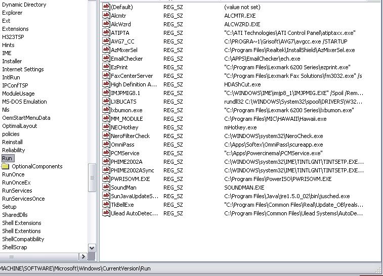

    Yeh i did locate the subfolder, below is screen shoot
