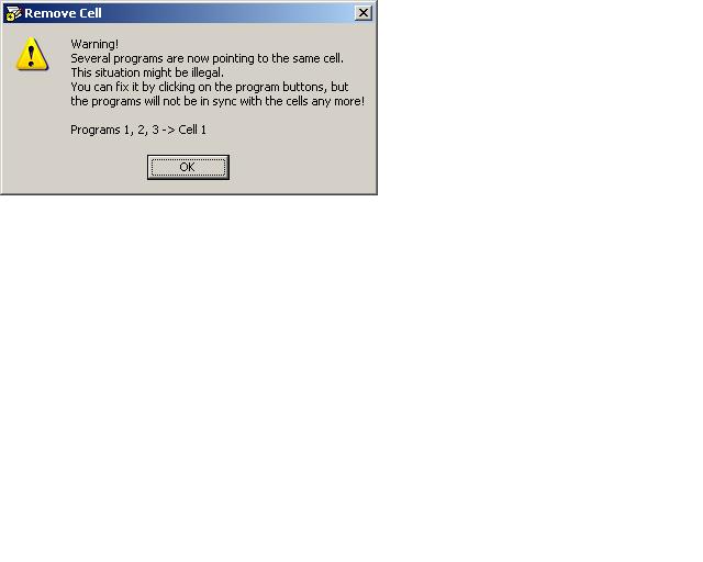

I have a PAL DVD backup (just VOBs). When I open it in PGCEdit, I see that the two first cells are dead (when I click them and open, they do not play). If I remove them, PGCEdit gives error message (below). If I ignore the message and save the backup with the two cells removed, I see the cells (DVD menu picture though there is no DVD menu in the backup) when I play it with DVDShrink or NeroPlayer.
Initially the backup had VTS_01_0.VOB that was the DVD menu picture (one of the dead cells that I see in PGCEdit). I deleted it before creating IFOs with IfoEdit.
May be this creates the problem? If this causes the problem, what should I do to remove it as I do not need the menu. Thank you!

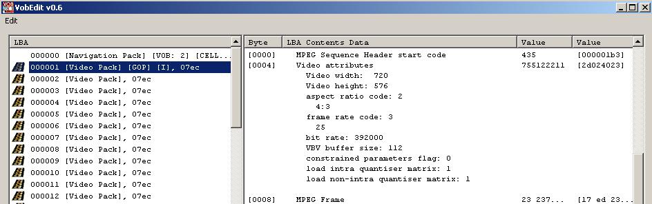

Showing video detail from vob using vobedit .

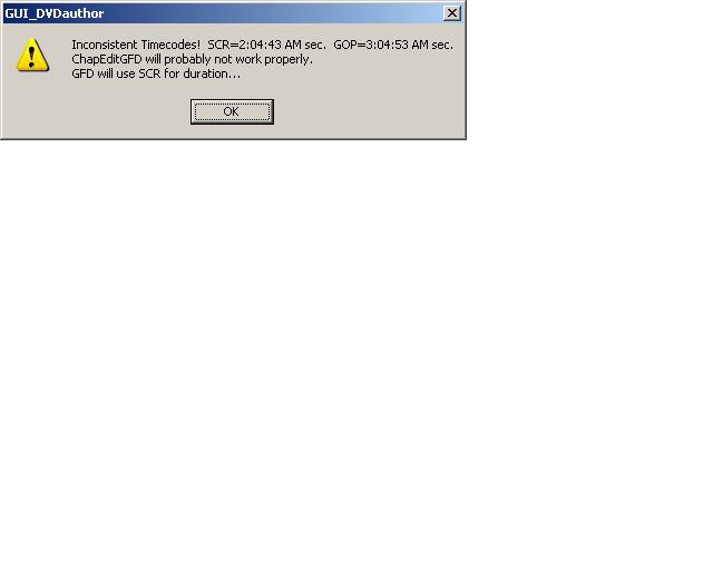

Thanks for the advice. Yes, now it "sees" the mpg file but once I drag the file into conversion area, I get error message. What does it mean? Can it be corrected or I can just ignore it?
When I play the mpg file with MPC, I see a sort of two streams: the movie and something like extra material about creating the movie. The second appears for a sec and goes during the movie playback.
Thank you!
Did you try to author the mpeg with GfD, did it work?
What you could try to get rid of the error-message is demux the file with PVAStrumento. Then drag the resulting videostream (.mpv) to GfD workspace, but you should try first to author anyway.

Thank you very much! It "sess" the file but it gives the error message (above).
But I've found the way around: I've found another backup and this way "fixed" the problem. Thank you for your time.
